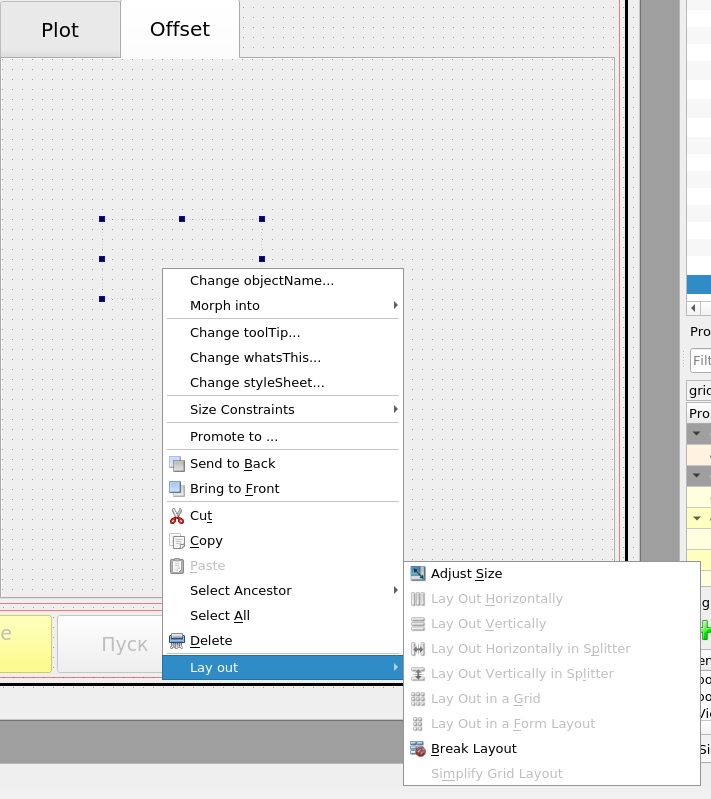

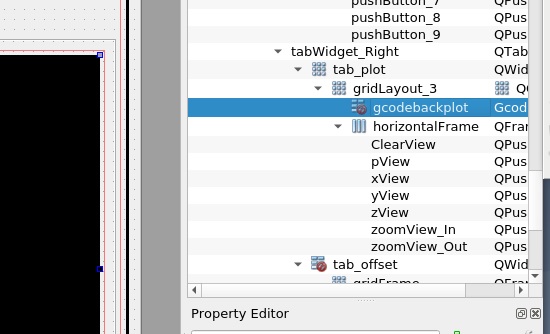

I moving forward in tutorial and now it seems that I found some Bug. Before this time everythnk was fine.
I work under lesson about offsets and I need to add grid and to expand it to frame
But I "Lay out > Lay out in a grid" is inactive.
And also in the next page I see some strange "stop" subIcon near "jcodebackplot" as in the next picture
How to solve this problem? And what problem is about?

- KCJ
- Posts: 328
- Thank you received: 267
31 Dec 2020 14:55 #193656
by KCJ
The reason the layout menu options are disabled is there is already a layout set.
You can tell this because all the layout options are disabled, but the break layout option is enabled.
You will need to break the previous layout before you can apply a new layout.
The subicon on the object browser means that that item does not have any layout set yet.
Thanks for noticing the typo in the offsets tutorial, I will fix it.
Happy new year!
Cheers,
Kurt
