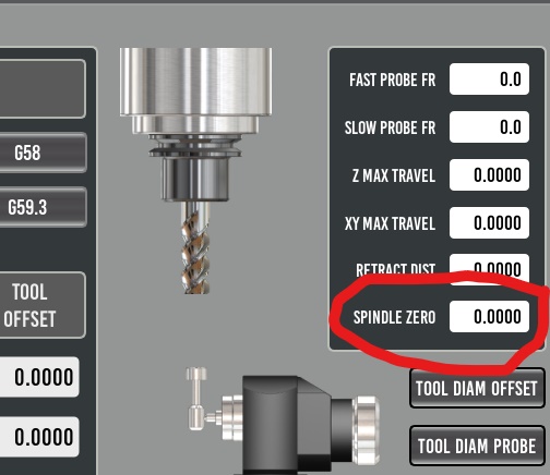

18 Jan 2021 13:50 #195790
by Lcvette
Replied by Lcvette on topic electronic tool setter, tool touch off process
all of these boxes must be filled in for touch off to have its user inputs defined and function properly

18 Jan 2021 13:54 - 18 Jan 2021 13:56 #195791
by swalts
Replied by swalts on topic electronic tool setter, tool touch off process
oh Dang!
Will this populate automatically when the sensor triggers?
Will the process look like this.
1. Load tool zero
2. touch off tool (spindle nose)
3. spindle zero (circled above) is now populated
Thanks for the picture. making the jump from Mach to Linuxcnc has been a humbling adventure.
I really appreciate all the help.
1. Load tool zero

18 Jan 2021 14:04 #195792
by Lcvette
no, you need to manually enter the spindle zero, record the number as positive, ie if the dro reads -12.375" record spindle zero height as 12.375. then it should work as intended!
