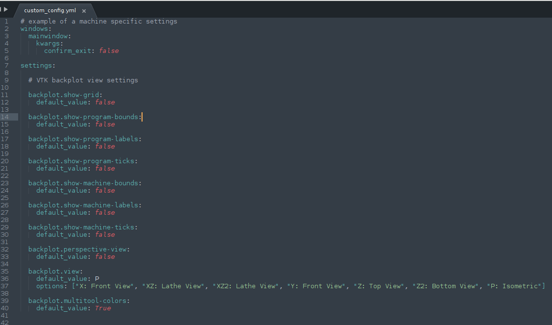

I added a VTKBackPlot to the form,
and below into the INI file.
It does not update the view accordingly.
2-
Also, what would be the equivalent of "show_extends" in axis, in VTKBackPlot. I have seen somewhere on the forums with extends shown, I just could not figure out how to turn it on.
Thanks in Advance.
[VTK]
MACHINE_BOUNDARY=on
MACHINE_TICKS=on
MACHINE_LABELS=on
PROGRAM_BOUNDARY=on
PROGRAM_TICKS=on
PROGRAM_LABELS=on
1-
2-
Thanks in Advance.
[VTK]
MACHINE_BOUNDARY=on
MACHINE_TICKS=on
MACHINE_LABELS=on
PROGRAM_BOUNDARY=on
PROGRAM_TICKS=on
PROGRAM_LABELS=on

Thank you. yml files seems to be very touchy. No tabs, make sure to have spaces etc.

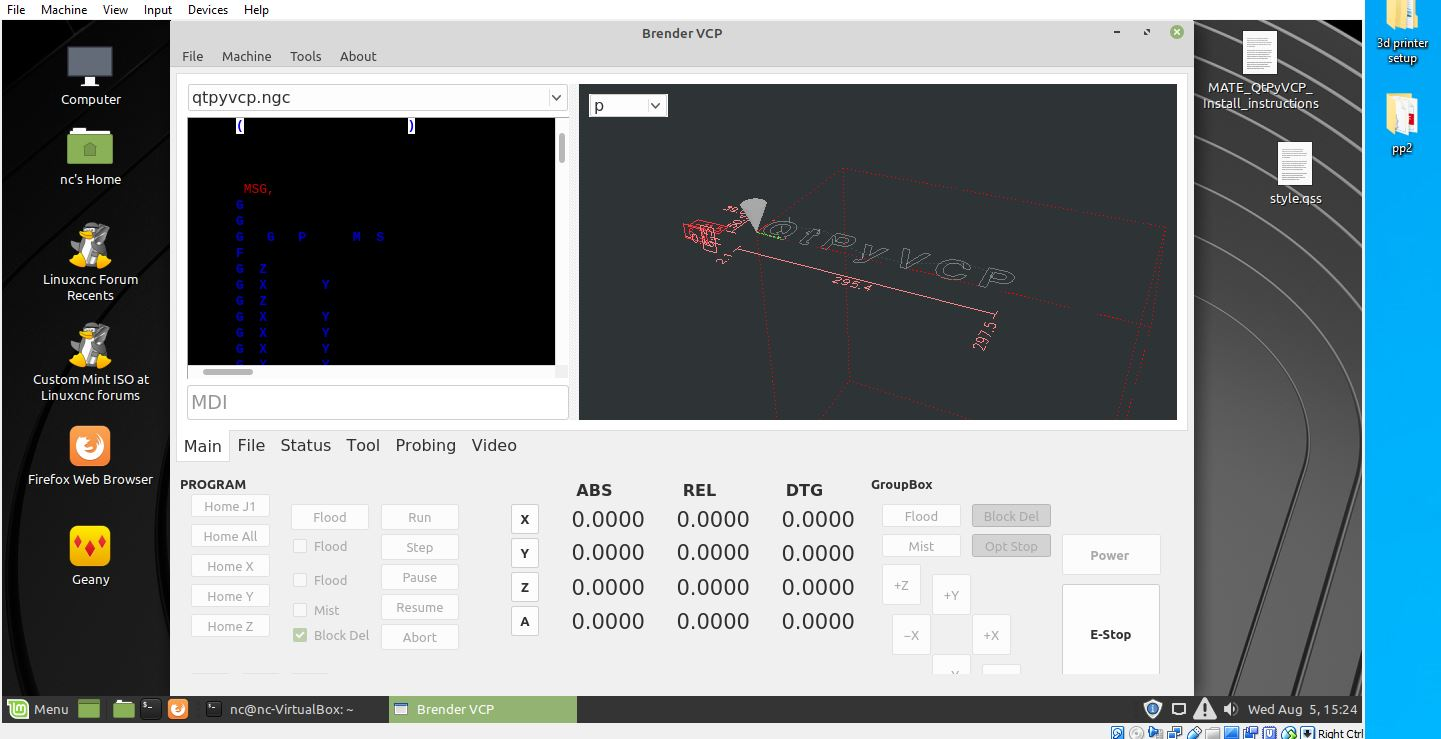

However, I still cannot do what is done on the attached image taken from the post below.
forum.linuxcnc.org/qtpyvcp/39674-cant-lo...-rules-editor#199101
I believe it should be backplot.show-extends or similar but this did not work for me.
Any thoughts?

18 Feb 2021 16:59 #199299
by Lcvette
Replied by Lcvette on topic PROGRAM_BOUNDARY = on in INI file does not register on VTKBackPlot
the backplotter you are using in that image is not the VTK backplotter so the yaml file is not going to work for it. you could use the vtk backplotter widget instead and then it would work, as of now the other backplotter is not supported fully in qtpyvcp i don't think.
- RBC
- Posts: 42
18 Feb 2021 17:11 - 18 Feb 2021 17:21 #199300
by RBC
Replied by RBC on topic PROGRAM_BOUNDARY = on in INI file does not register on VTKBackPlot
I see now. The GcodeBackplot shows the extends. Thanks.
