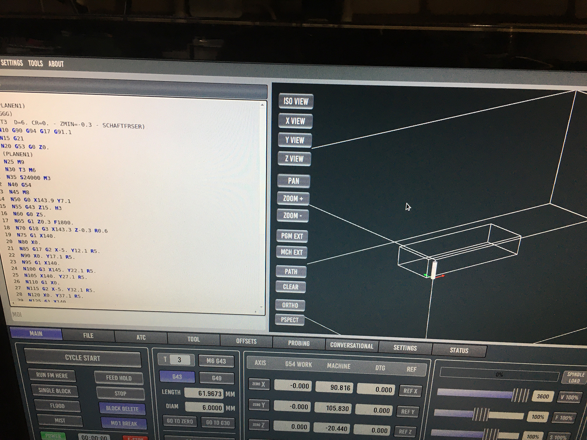

Hello,
I have a problem with the Backplot. I want see the Backplot before I start milling. Like the Axis screen.
But I only see the Backplot after milling.
Where can I change that ?

can you send me your gcode file, i am not sure why you are not seeing the backplot i have not seen that before. also how did you install probe basic? the plot should be showing up when a program is loaded.

I had such problem when in g-code was some mistakes.
Also I added button for refresh back plot, because of changing G-code it doesn't refres automaticaly.

The Backplot works in the normal Axis mode. I dont think the problem is in the g code.
How do you added the button for refresh the back plot ?

From this
tutorial
Except when you configure signal, you need to look for Refresh signal.
