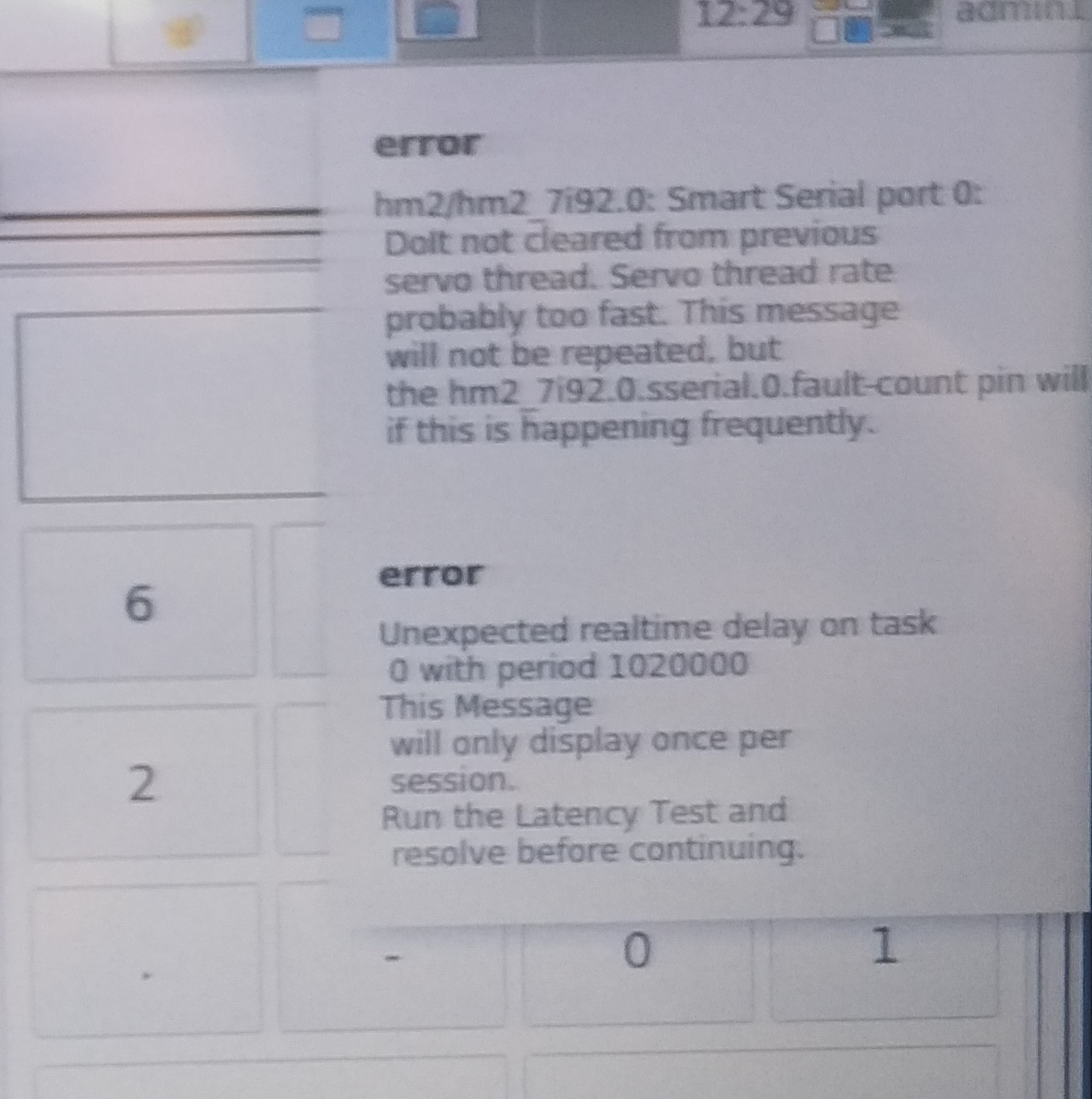

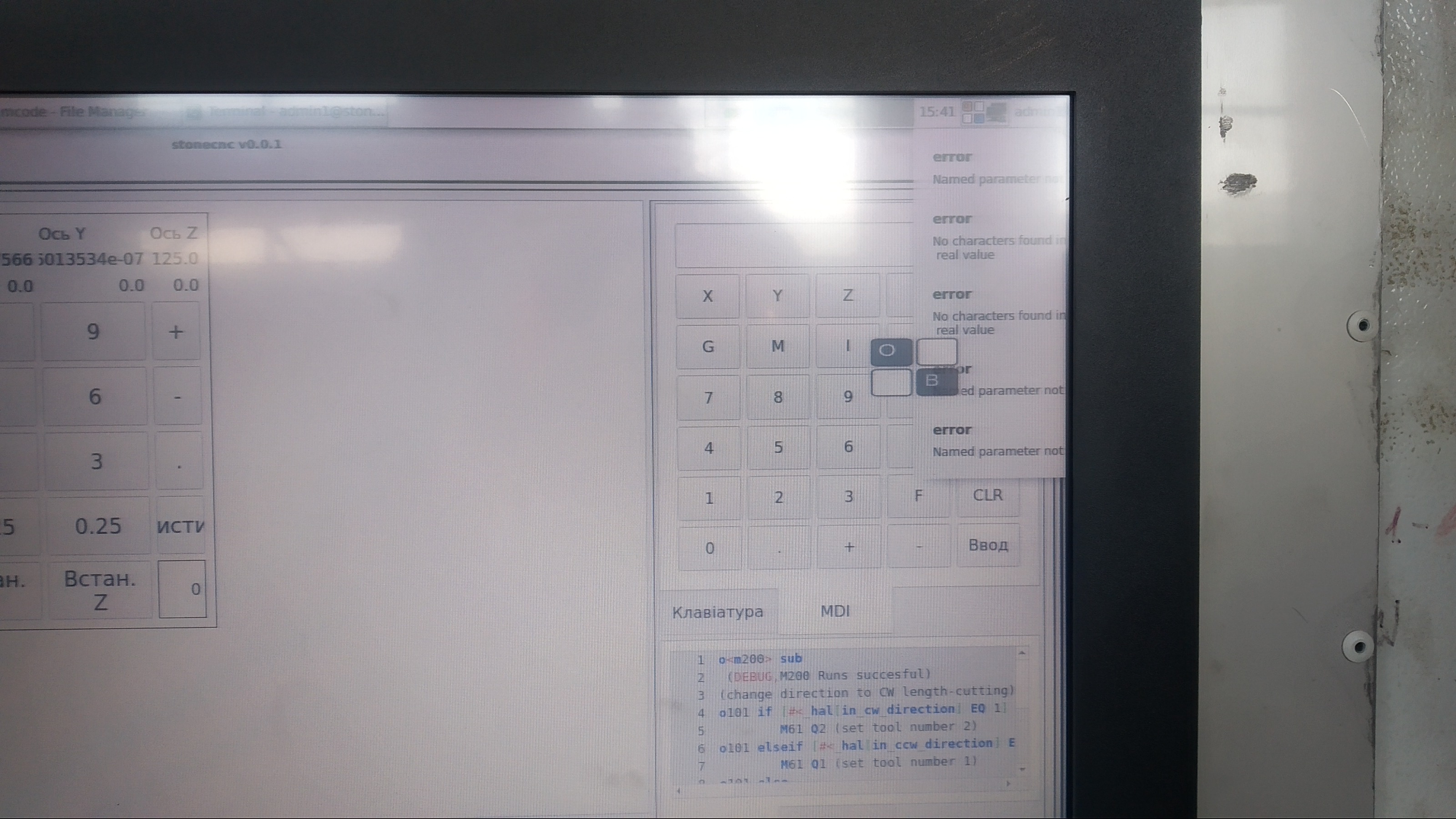

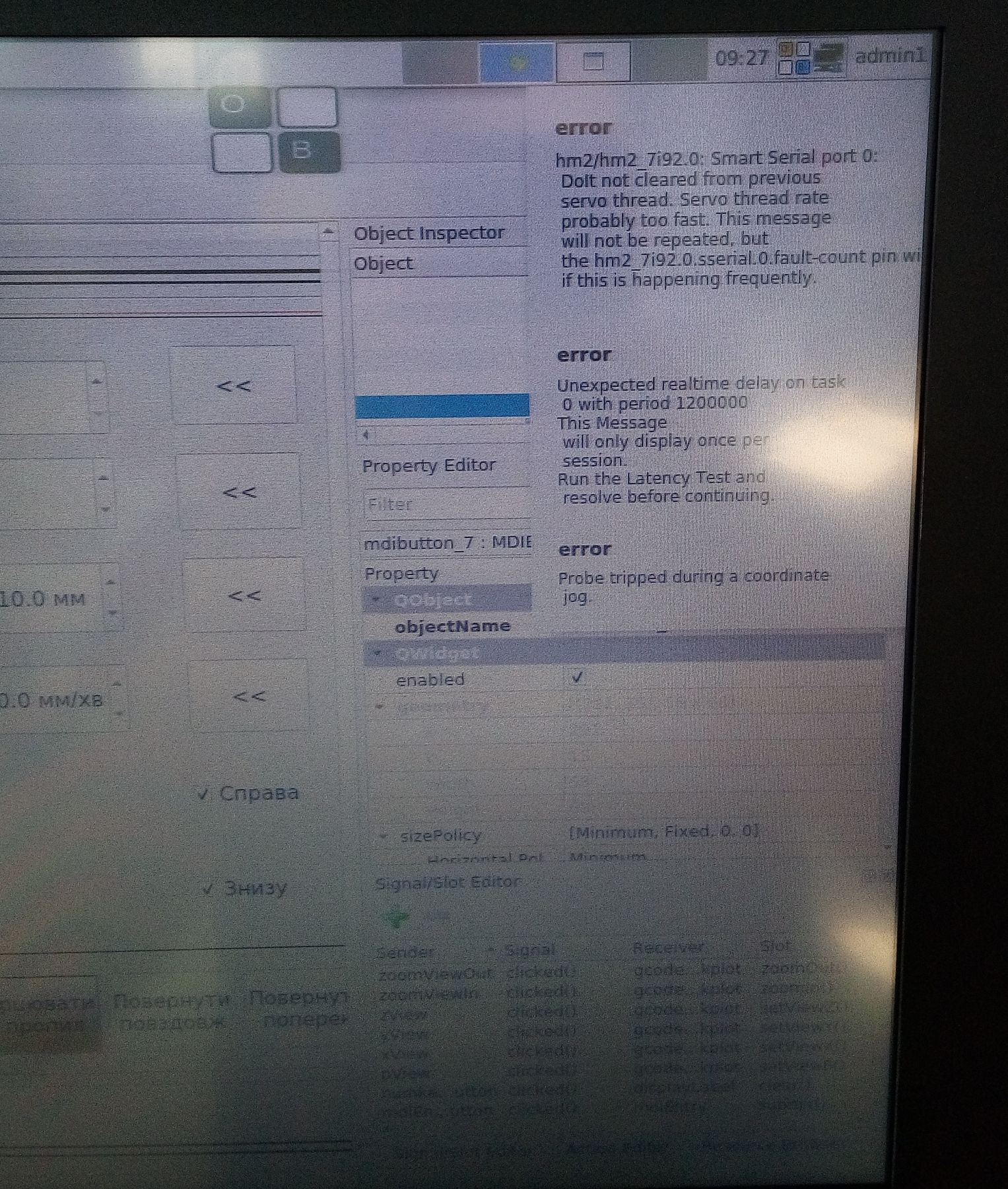

I add photo of the messege output.
It seems that when text in output messege (debug, .... system messege) text become very wide, it hides out of the screen and I even can't close messege windows.
I also see, that when I change some value with mouse in qhspinbox (sorry if I wrong in naming), I can't move axes with keyboard default keys or any other jog commands from qtpyvcp. Possibly it goes in some manual mode or something else.

31 Jul 2021 08:08 #216429
by aleksamc
Replied by aleksamc on topic Bug in messege output
I have updated to last version to qtpyvcp with pip.
But I still feel problem with messege output for big texts.
As on the picture - it's impossible to close this messege windows.
So does it's possible to disable such kind output messeges and to leave only small messeges?
As for this error, I don't know how to solve this, sometimes PC maid lags and this messege shows up. But it do nothing for program. It would be very nice to have some botton to close this windows may be in qtpyvcp UI.
- TurBoss
- Posts: 134
- Thank you received: 81
31 Jul 2021 09:36 #216435
by TurBoss
Replied by TurBoss on topic Bug in messege output
hello,
you can try the dbus notifications by adding this to the vcp yml
data_plugins:
notifications:
provider: qtpyvcp.plugins.notifications:Notifications
kwargs:
# show notification popups
enabled: True
# "native" or "dbus"
mode: native
# max number of notifications to show
max_messages: 5
# whether to save messages on exit
persistent: True
you may also need python-dbus
data_plugins:
notifications:
kwargs:
enabled: True
mode: native
max_messages: 5
persistent: True
The following user(s) said Thank You: aleksamc
- aleksamc
- Posts: 569
- Thank you received: 67
02 Aug 2021 09:12 #216677
by aleksamc
Thanks, TurBoss, for your answer.
I have python-dbus installed (possibly with installation qtpyvcp)
As for editing yml-file I don't understand what I should to edit.
I add my yml file to this post. What I should to change?
- Joco
- Posts: 532
- Thank you received: 327
02 Aug 2021 10:00 - 02 Aug 2021 10:03 #216683
by Joco
Replied by Joco on topic Bug in messege output
Look in your yaml file as posted for the section that has this text:
The using the content TurBoss supplied make it look like:
Cheers - J.
data_plugins:
status:
kwargs:
cycle_time: 75The using the content TurBoss supplied make it look like:
data_plugins:
status:
kwargs:
cycle_time: 75
notifications:
kwargs:
enabled: True
mode: native
max_messages: 5
persistent: TrueCheers - J.
