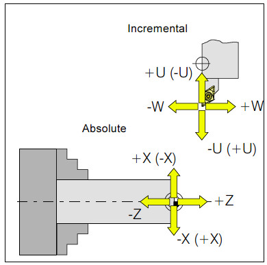

06 Oct 2021 14:48 - 06 Oct 2021 14:50 #222366
by spumco
I can confirm this. Older Fanuc controls in dialect "B" and "C" (European-type) use G90/91 to switch between absolute & incremental. In "A" dialect there is no switching, so an incremental move is directly programmed using U or W with no mode switch.
For a Fanuc lathe, G28 U0 W0 results in a return to reference point (tool change position) with no specific incremental intermediate points.
Replied by spumco on topic Probe Basic - is it possible to embed a GladeVCP tab in the QtVCP GUI?
I also have noticed the G28 U0 W0 trying to use the last fusion 360 post pro
I think that some lathe controllers use U and W for relative moves. They certainly shouldn't be inserted in G-code targetting a machine without those axes.
Last edit: 06 Oct 2021 14:50 by spumco. Reason: added diagram
The following user(s) said Thank You: alkabal
