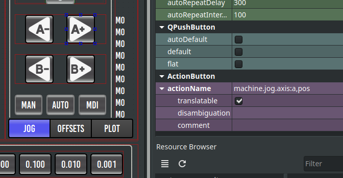

if you could create a actionbutton and set ActionName to
machine.jog.axis:a,pos
or
machine.jog.axis:a,neg
or
- spumco

26 Oct 2021 17:49 #224437
by spumco
Replied by spumco on topic Probe Basic - rotary axis jogging
