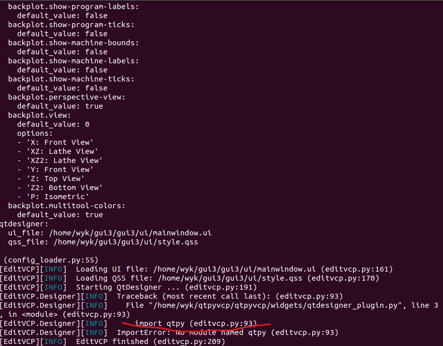

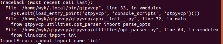

21 Oct 2021 00:51 #223726
by yi2580
Thank you for helping me find my mistakes
Replied by yi2580 on topic Qtpyvcp has no Linux CNC components
This error occurred again after I entered qtpyvcp - I. I don't know if it affects my use.What output do you get from in terminal from:
qtpyvcp -i

21 Oct 2021 02:32 #223751
by Joco
Replied by Joco on topic Qtpyvcp has no Linux CNC components
editvcp is never going to work as there is a more fundamental issue. qtpyvcp is not correctly installed. Which all leads on to the linuxcnc controls appearing (or not as is this case) in QTDesigner.
I am afraid you need to go back to www.qtpyvcp.com/install/prerequisites.html# and ensure all dependencies are in place, .local/bin is in your path and that qtpyvcp is functional. Please note the supported and recommended development OS's (Debian 10 and 11). As noted before I would suggest using Debian 11 as I know that works well for python3 based work. Which is what your linuxncc rip will be (assuming you check out master).
If you really want to use Ubuntu 18 then I am afraid I will need to "tap out" as I never attempted to setup for that OS.
Thanks.
Thanks.

21 Oct 2021 05:33 #223780
by Joco
if you continue to get a qtpy import error then one of the key dependencies has not been installed. either that command line has not been run or rerun since installing python3 or its something screwy with Ubuntu.
