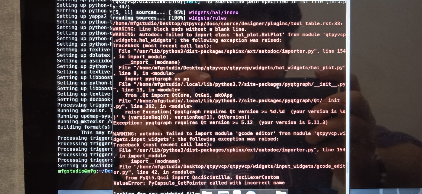

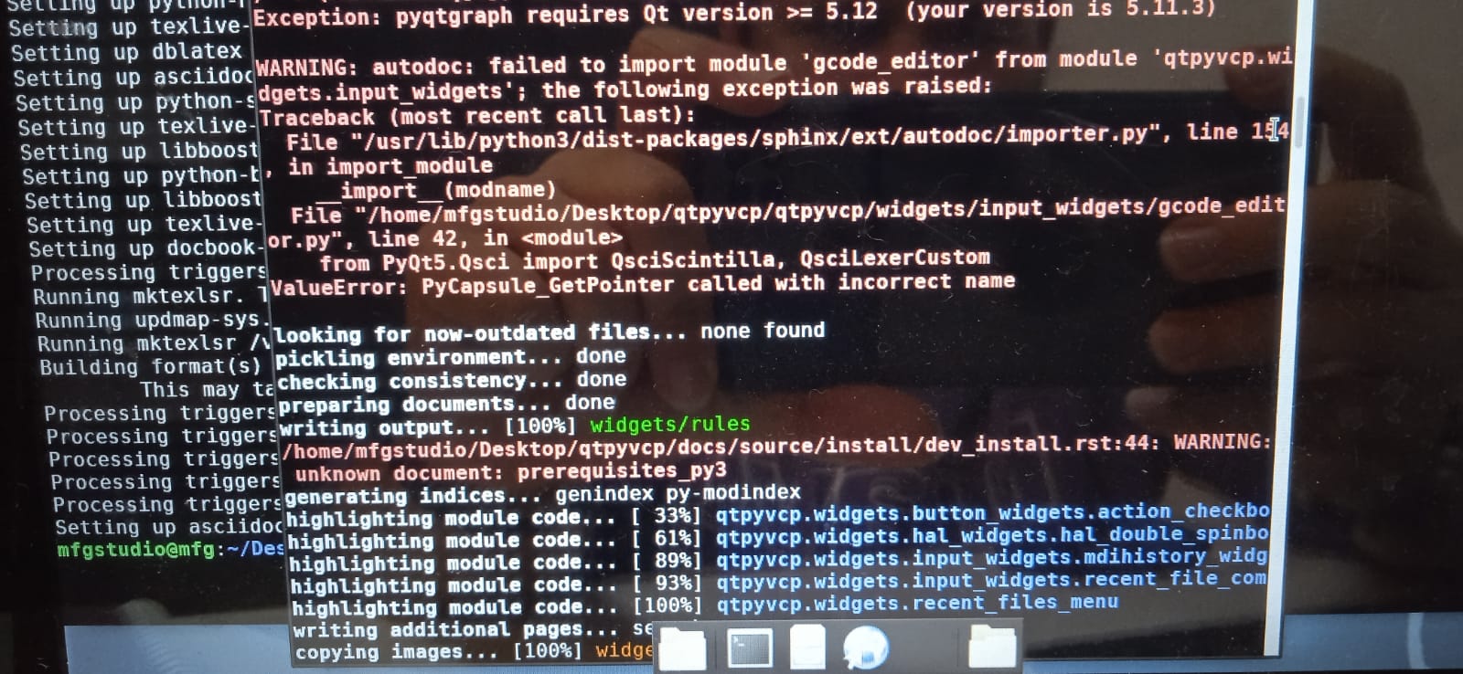

I am trying to use qtpyvcp with python3 but I am getting errors on this thing. I did everything and run make html command, it gives me errors and also successfully finishes its process. I thought nothing was wrong but when I am trying to run editvcp it gives me ValueError: PyCapsule_GetPointer called with incorrect name and says me that autdoc needs qt12, not qt11.3 (or sth. like that). But before it says autodoc: failed to import class 'hal plot.Hal Plot' and more errors. At last, I can't get my linuxcnc widgets and thats what I need now. What is this problem, I am doing everything that is written. I really don't understand the problem man.

This might already be your answer: autdoc needs qt12, not qt11.3

So you are aware, with the move to py3 many of the team are running Debian 11 or equivalent distro to have a clean/untainted py3 environment. Some are even flirting with arch linux. The point being these tend to give you qt15.x and solve a bunch of dependency issues that plague trying to move older OS’s forward.

I understand what I need right now. At first, thanks everyone for fast reply. I was using debian 10 and it has qt5.11.3 inside. I asked my friend who worked with this past years. He said you can do the installation with python2.7 and don't get this errors. I did that and everything is fine now. For now I will go with python2.7
I dont wanna waste time on this thing now, when I finish my project, I will try with all the things with latest update.
