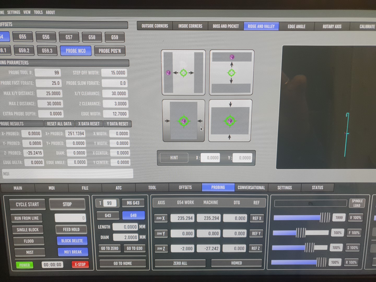

Hello,
i am struggling around with my 3d Probe and Probebasic, the probe is working and is triggering when hitting an item. But if i try to use an probe script, the probe is moving the wrong way. example: i use the script to measure an block, from -x to +x ( the Field with the cursor on the picture )
The probe is situated in the middle of the block.
If i start the script, now happen
Probe goes down on z and touch the surface, that go 3mm up and than travel to -x, puts the probe down to -z2 and than move the cursor to the right and touch the block.
Until here everything seems to be correct, but now the probe moves further to the left and trys a new hit ( normally the probe should go to left and moves back in left direction until it hits the block)
I ve tried a many numbers of the probe parameters, but nothing worked correcly.
May be someone have an idea, where to can look the mistake,
best regards
Chris

Did you enter a hint for the part dimensions?

I also think that the value was not given in the hint field, but I didn't set it at the beginning because the field looks like you can't enter anything because it's so gray. Just click in the hint field and give a value.

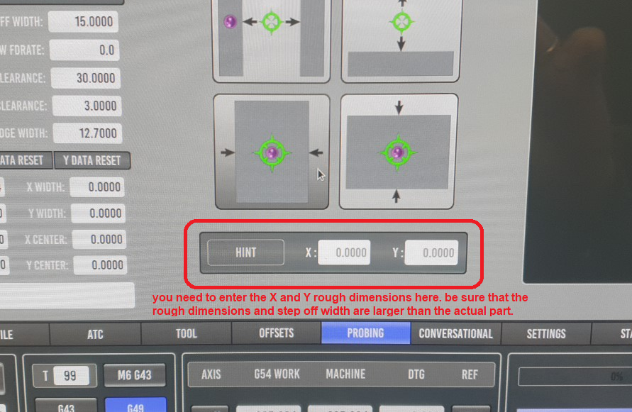

Please see image below:
I apologize for reopening this old topic but had the same issue recently and wasn't sure how to address it until I found this post.
Regarding using the 'HINT' area to input these values; are there any instructions for the Probing function that includes this, and other, information ?
The existing help files are nice but don't include all of the different settings.
Thanks !
Jay

There are not at the moment, the hint input I think and maybe the edge angle are what is missing from memory. I haven't had about of time to add what's needed, maybe 2023 I will find a few skate moments to get to it.
