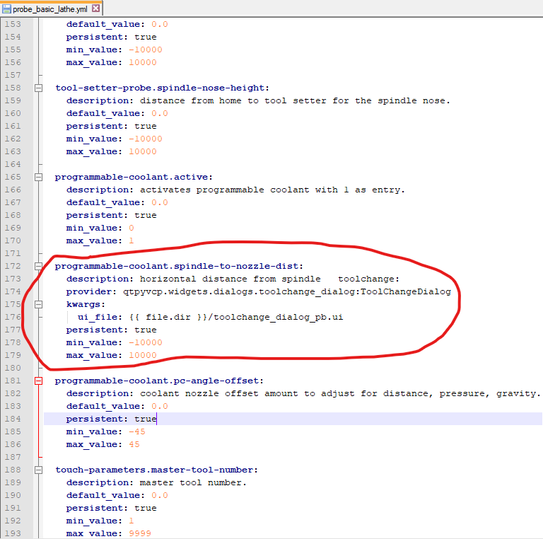

I have a similar issue. I installed the debian12-iso from the linuxcnc download page today. But if I start the Probe basic lathe I get the same error.
I think there is a problem with the probe_basic_lathe.yml (see the picture below).

looks like a probkem with a tab or so, where toolchange: is defined

not a tab, there is something completly wrong in the yaml file
src/probe_basic_lathe/probe_basic_lathe.yml whats curretly the last in git
at line 172 around it should look like this:
but currently it looks like
a bug came in on Nov. 16th here
programmable-coolant.spindle-to-nozzle-dist:
description: horizontal distance from spindle centerline to nozzle centerline.
default_value: 0.0
persistent: true
min_value: -1000
max_value: 1000
description: horizontal distance from spindle toolchange:
provider: qtpyvcp.widgets.dialogs.toolchange_dialog:ToolChangeDialog
kwargs:
ui_file: {{ file.dir }}/toolchange_dialog_pb.ui
persistent: true
min_value: -10000
max_value: 10000

whoa, ok, fixing

Edit... found it.. missed this was in the lathe yaml.. fixed and pushed, give it a few minutes to rebuild the debs in the repository and publish

Now it works
