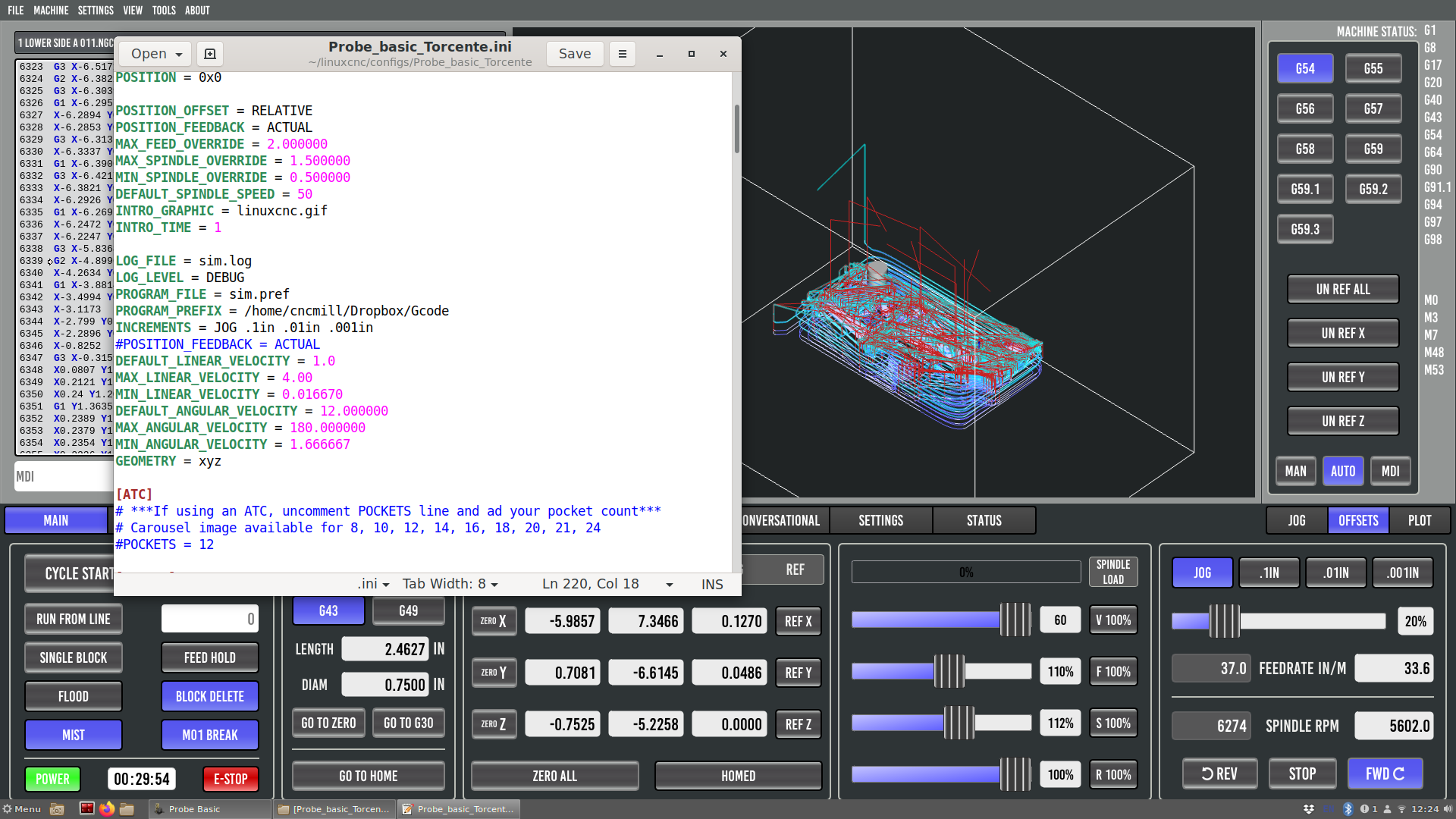

Good afternoon,
I noticed while running a program that the rapids seems stuck at 60ipm, my machine is capable of running faster than that (and does when it uses a G1 as a rapid movement instead) but when a G0 is commanded it only runs at 60.
Ive attached a screen shot of what I am seeing in my INI and on the GUI

Replied by Lcvette on topic Probe Basic rapids
can you post your whole ini file for us?
it is in inches per second, so setting of 1.0 inch/sec = 60 ipm should help figure out your desired max speed, but typically will match what you have higher up in the ini file from the pncconfig output think yours was 4.0 which is 240ipm

Replied by natholego11 on topic Probe Basic rapids
worked Perfectly, Thank you!
