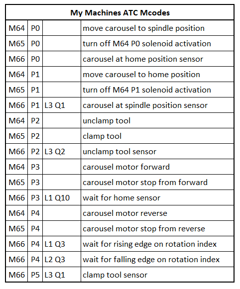

if you have setup your atc macros, they use multiple M64, M65, M66 calls which are outputs and inputs as defined in function here:
linuxcnc.org/docs/2.8/html/gcode/m-code.html#mcode:m62-m65
your setup may be diffrent than others depending on wiring, so that is left to the user to setup. the P# after those calls is your pin number to activate/deactivate/read/ etc. as an example for my machine I have setup a cheat sheet for servicing the ATC in the event of an issue such as a stuck tool or failed sensor read etc. the below cheat sheet and hal io section should help guide you.

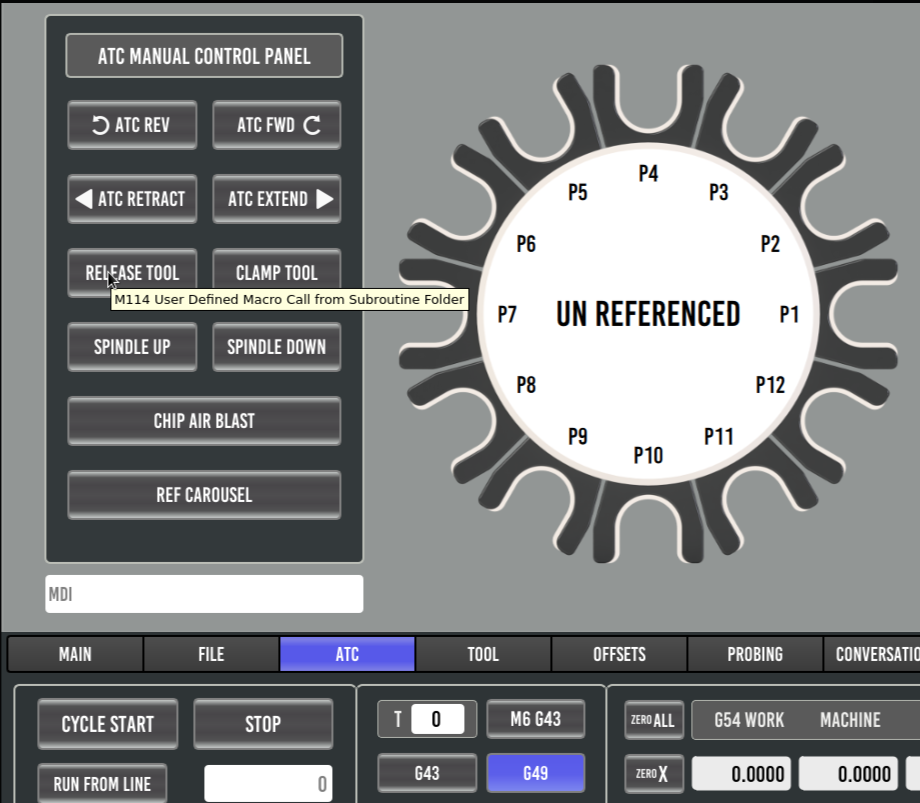

i did some editing, initially long ago when i first laid out the atc page i used tormach's manual button offerings not knowing much about atc functionality, since then i have learned much more and have edited what is there to better reflect a functioning atc. I have also added tooltip pop ups that are on prior to putting the machine in the homed status. they are just on the atc page in the manual buttons group, but i will start adding them to all of the items in the gui for sort of an on the fly helper. i have plans to add some much nicer pop ups with graphics that would illustrate certain things, but i have yet to find out how to make that work, and it has been back burnered in lieu of more pressing items.
so if you want to know what is connected to the buttons, you would just hover over them and make notes on what you would edit. once you define those macro's the are hot and ready to boogie!
