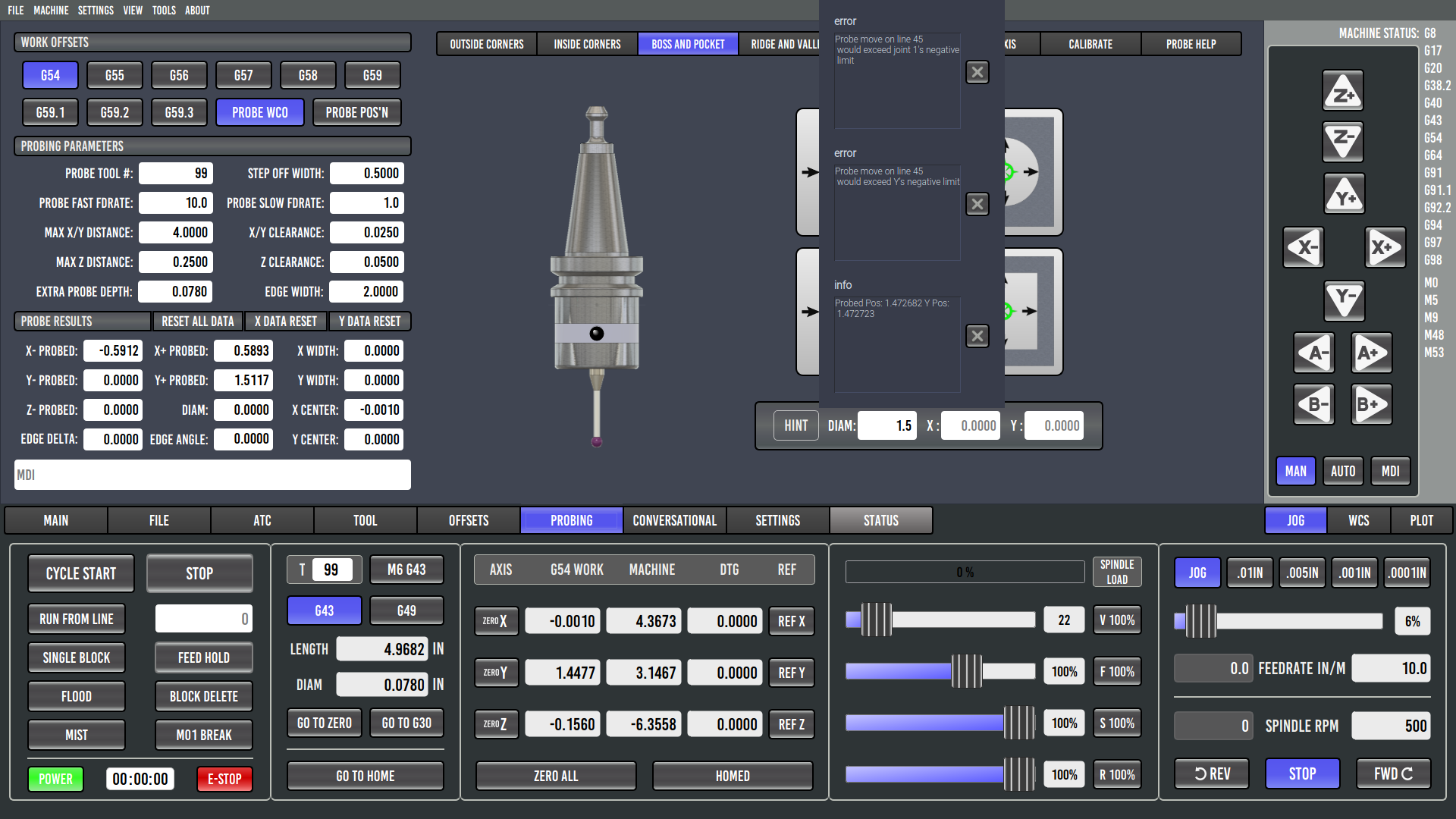

Just got my spindle probe hooked up and seems to be connected properly, but I'm having issues with the probing routines in Probe Basic.
So far I've only tried a few routines, but the internal round pocket and the probe tip calibration routines both error out before finishing. Specifically, the two routines are
- probe_cal_round_pocket.ngc
- probe_round_pocket.ngc
The issue is that after the X- and X+ touches, the probe moves to the middle and probes Y+. After probing Y+ the second (slow) time, it stops after the second retract and throws two errors instead of moving Y-: "move would result in exceeding joint 1's limits" and "move would result in exceeding Y axis limits".
E-stop isn't triggered, but the probing routine stops and the WCS isn't updated. I've tried adjusting the 'hint' diameter up and down, as well as set-back, max X-Y distance, and other values on the probing screen.
Same thing happens during the probe tip calibration. I'm probing in the middle of my axis travel range - nowhere near the hard limits or soft-limits.
Probe routine for an outside corner worked fine. I'll try an internal square/rectangle this evening, but does anyone have an idea what the issue is?

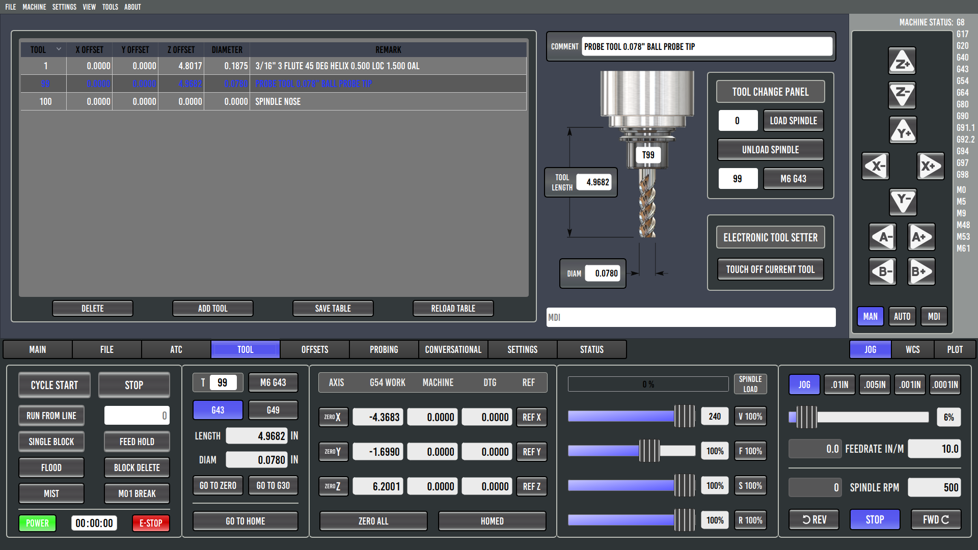

I've used them all in both master branch and 2.8, they all work fine when properly set for myself, what are your parameters? Can you post a screenshot? What is the tool diameter and is it set in the tool table? This must be done prior to running calibration. Then calibration will be added to the routine when run. If all that is as it should be you can try running with slow probe set at 0.0000 and run your fast probe feed at 8i-10ipm. Sometimes if it's set too slow the probe itself will double trigger causing some issues.
this is not an issue in the routine but a mechanical issue. Also what are your probe parameter settings? Can you post a screen shot of them?

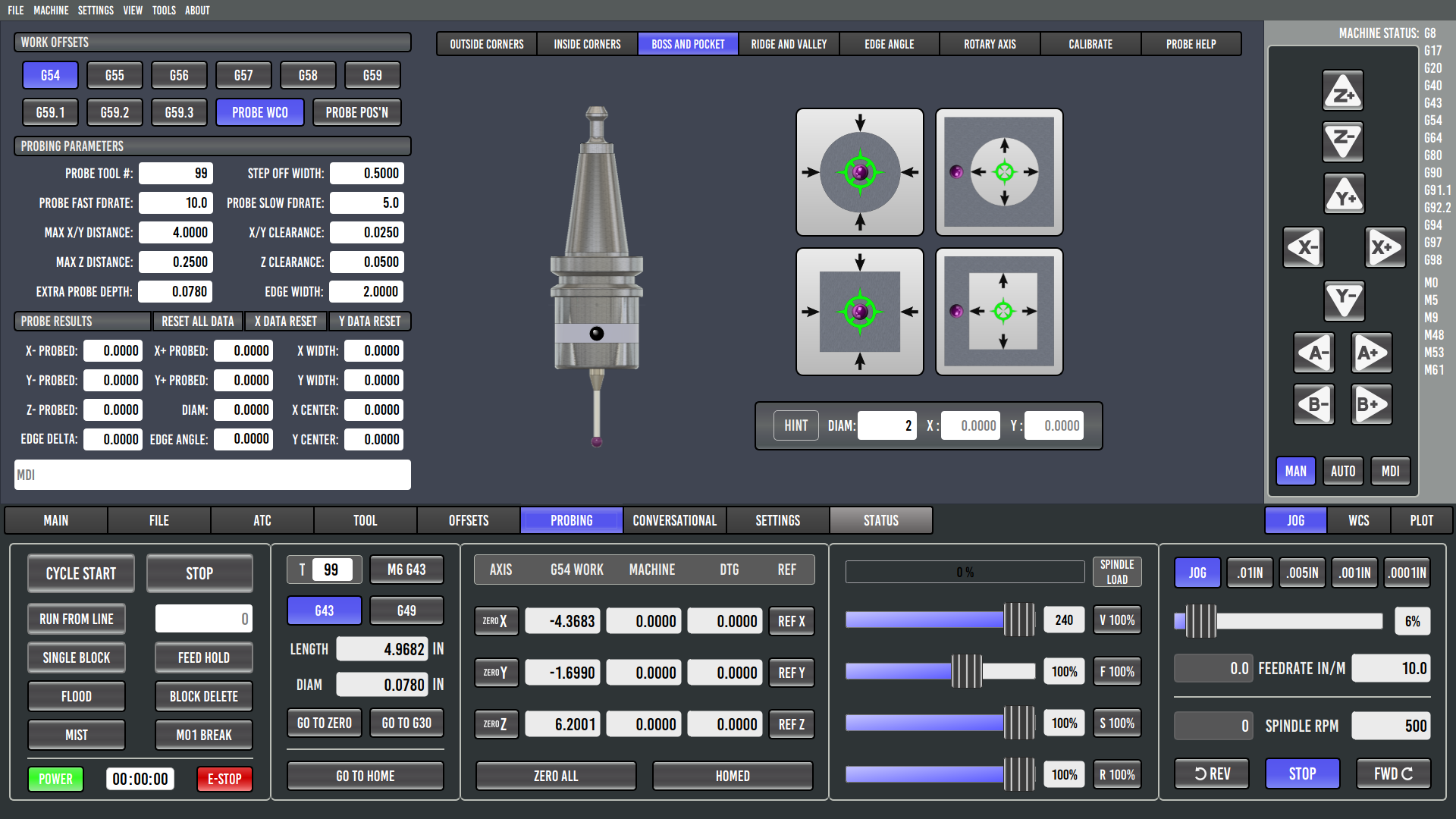

More testing just now: all new attempts to probe in Y- fail. Boss, pocket, valley - even a simple Y- edge touch fails.
Screenshots attached with tool and probe tabs. Last screenshot is with the error messages displayed. The line number referenced in the error changes depending on the routine, but it's essentially the same.

05 Apr 2022 17:49 #239398
by spumco
Replied by spumco on topic {Solved} Probe Basic - probing routine errors
Chris - thanks for giving my brain a poke.
I think I got this sorted out. My max XY distance was greater than the available travels in the Y- direction. Had my bearing race too close to the front of the table - probing would have been fine, but the PB routine obviously calculated the max travels if it missed the 'hint' or calibration distance and compared it to the G53 remaining travels and threw a wobbler.

05 Apr 2022 18:53 #239404
by Lcvette
Replied by Lcvette on topic {Solved} Probe Basic - probing routine errors
Check the probe help tab if you need some imagery of what each parameter is, it has the definitions for the probe parameters. max xy distance is the max amount it will travel during the actual probe move before erroring out if no contact is made. The step off width is how far it will step off the edge from the starting position after probing in z minus direction. The hints are the rough stock size, step of width is added to hint to give clearance. I typically set max xyz to 0.5" and step off to 0.375"
