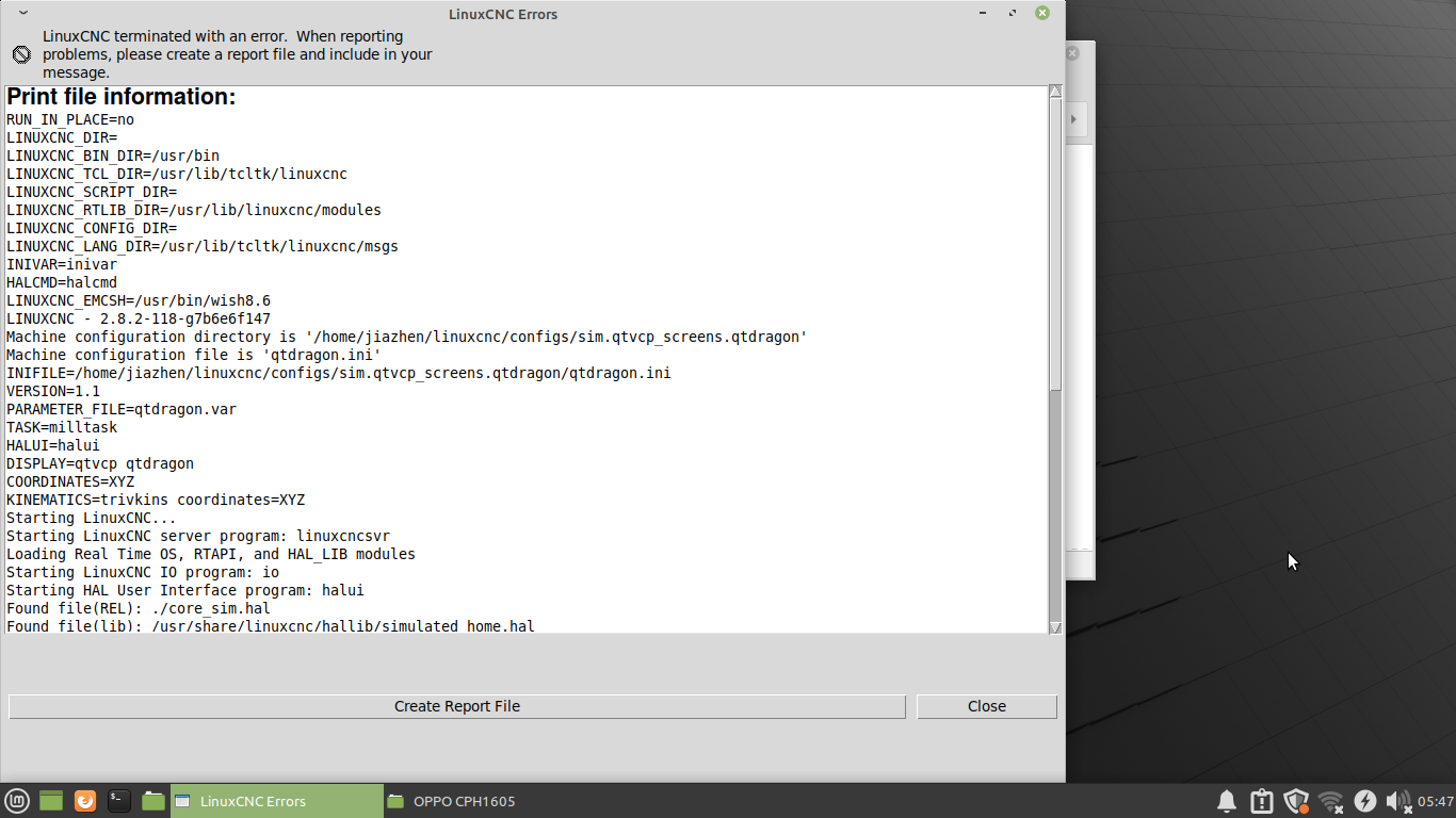

There is no useful info on those screenshots, we need the "debug" part of the error, or sometimes just above it.

This my report (im use linux mint for my base) :Error report created by /usr/lib/tcltk/linuxcnc/show_errors.tcl:

ImportError: No module named PyQt5
There is no PyQt5 or an older version is installed and can not be used.
Try this, it did work on Mint perfectly.
Since you did not provide us with what version of Mint, not sure if it will work for you.

Linuxmint Linux Mint 20.2 20.2 uma
I missed this while i was explicitly looking for it, it will most probably not work on Mint 20.x. due to Python changes.
