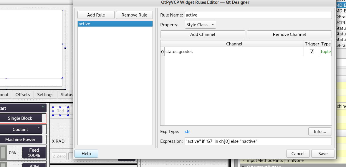

Developing my own lathe screen set and wondering if i'm doing something stupid.
Have the following in Style.qss
MDIButton [style='active']{
color:green;
MDIButton [style='nactive']{
color: rgb(255, 255, 255);
And the rule is as per the attached image but it doesn;t work. I;ve done similar for text elsewhere but I can;t get the button color to change.

Your rules and QSS look correct.
I wonder if your custom style is getting overridden by another style sheet..
Maybe try making the item selector more specific
#widget_name [style='nactive']{
Cheers,
Kurt
