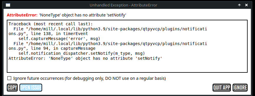

Trying to remap M6 for an ATC test. and LCNC is throwing an error Only thing changed from a working config was uncommenting the INI line:
Using stdglue.py, remap.py, and toplevel.py that came with Probe Basic sim.
Not linux-clever, so I've no idea where to start or what the errors mean.
MX 21
LCNC 2.9, RIP
QtPyVCP master
Probe Basic python3
REMAP=M6 modalgroup=6 prolog=change_prolog ngc=toolchangeRMC epilog=change_epilogUsing stdglue.py, remap.py, and toplevel.py that came with Probe Basic sim.
MX 21
LCNC 2.9, RIP
QtPyVCP master
Probe Basic python3

Tommy - can you move this to QtPyVCP for me?
I think "Notifications.py" is a qtpyvcp plugin thing, and this may get more attention in the appropriate sub-forum.
Thx,
Ralph
EDIT - yes, it's related to qtpyvcp, not that I know what to do about it.
github.com/kcjengr/qtpyvcp/issues/75
Thx,
Ralph

Hello!
this issue got fixed recently on qtpyvcp master branch at github
about the notification issue, I have to take a look
Edit:
The notification error may be fixed now
File "/home/mill/.local/lib/python3.9/site-packages/qtpyvcp/widgets/display_widgets/vtk_backplot/vtk_backplot.py", line 88, in __init__ self.active_wcs_offset = self._datasource.getActiveWcsOffsets() File "/home/mill/.local/lib/python3.9/site-packages/qtpyvcp/widgets/display_widgets/vtk_backplot/linuxcnc_datasource.py", line 155, in getActiveWcsOffsets xy.append(self.__getRotationOfActiveWcs()) File "/home/mill/.local/lib/python3.9/site-packages/qtpyvcp/widgets/display_widgets/vtk_backplot/linuxcnc_datasource.py", line 160, in __getRotationOfActiveWcs current_wcs = self.getWcsOffsets()[self.getActiveWcsIndex()] KeyError: -1this issue got fixed recently on qtpyvcp master branch at github
Edit:

What do I need to do to update my version? I presume it's a 'git-pull' thing, but I'm still at the cut and paste stage and could use something specific to paste in the terminal.
EDIT - I think I updated to the latest using python3 -m pip install --upgrade qtpyvcp (from the qtpyvcp install page.
Last error went away, but getting a new one. Sorry for the big paste, but I can't figure out where LCNC is storing the debug report file.

to get latest version from git you can do this
in the qtpyvcp directory
uninstall any version installed from pip before by running
thanks
edit:
WARNING:
will install the python2.7 version,
python3.9 -m pip install -e .in the qtpyvcp directory
python3.9 -m pip uninstall qtpyvcpthanks
edit:
WARNING:
python3.9 -m pip install qtpyvcpwill install the python2.7 version,
Last edit: 10 Jun 2022 19:10 by TurBoss. Reason: add warning
