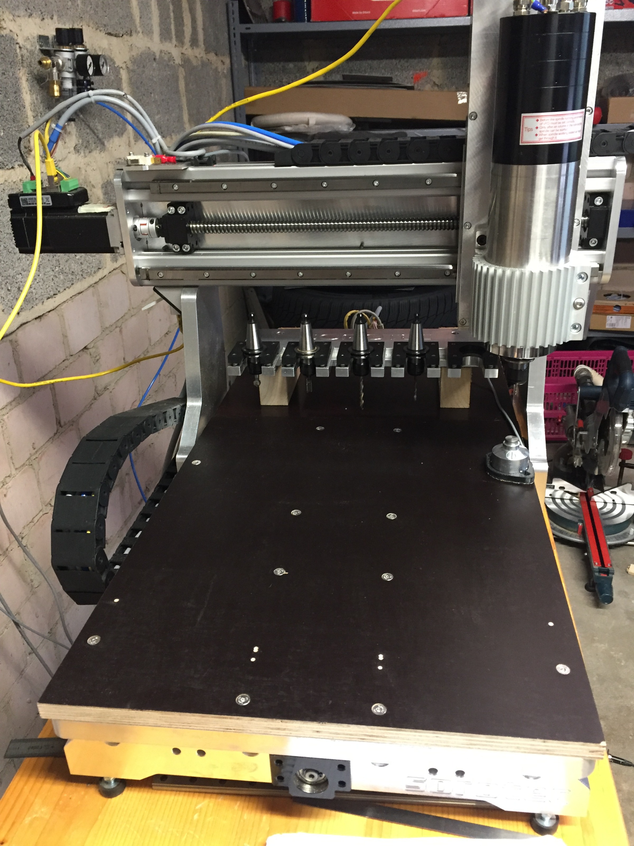

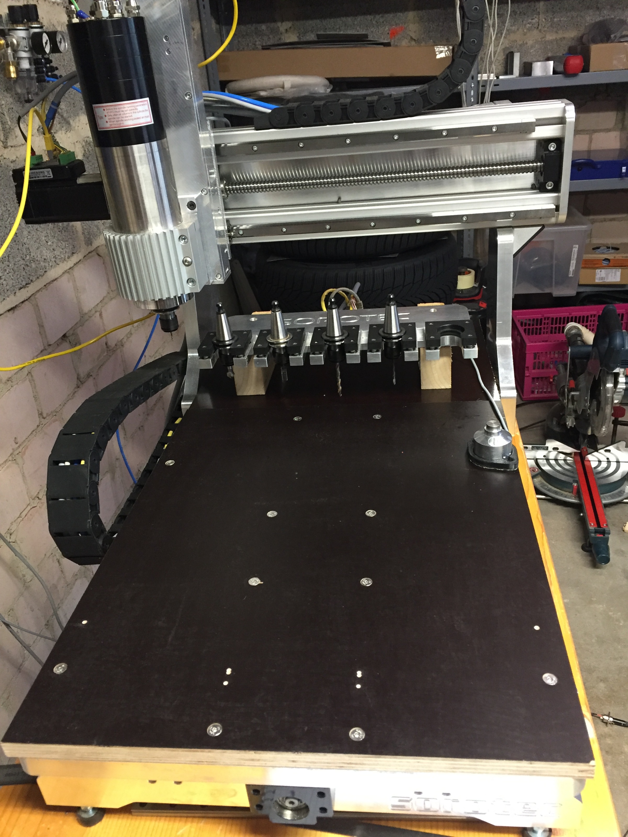

Back to the Problem that is not solved for years ! ( that's what it looks like )
SetUp : Mill
x-axis : 410 mmy-axis : 520 mmz-axis : 110 mm
home at : x0 y520 z110 ( left back top )
SetUp : ATC-Spindel
put air-pressure : drop_tool;
release air-pressure : pull_tool;
SetUp : Tool-Changer
Horizontal rack along x-axis at y520 with n-positions;
SetUp : Tool-Length-Sensor :
Tool-change Position at x385 y380 z110;
Trigger at x385 y380 z41.4145;
For the tool-change with PB I have 4 CASE plus some subCASE for each :
CASE_1.) change tool in auto-mode with G-Code in program : T5 M6 G43
CASE_2.) change tool in mdi-mode with G_Code in command-line : T5 M6 G43
CASE_3.) change tool by insert new tool-number (5) in PB and press button( M6 G43)
CASE_4.) change tool by hand at G30 ( and do, or do not touch-off )
So where do I get started
SetUp : Mill
SetUp : ATC-Spindel

m6 doesn't really have anything to do with probe basic or the GUI.
github.com/rmu75/rover-342-retrofit/blob...ines/rack_change.ngc is my impl of a rack tool changer on a large wood CNC machine.
Tools are kept in pockets that are individually raised pneumatically, this is controlled via M64 & co. I think the code has reasonable comments and could serve as a starting point.
