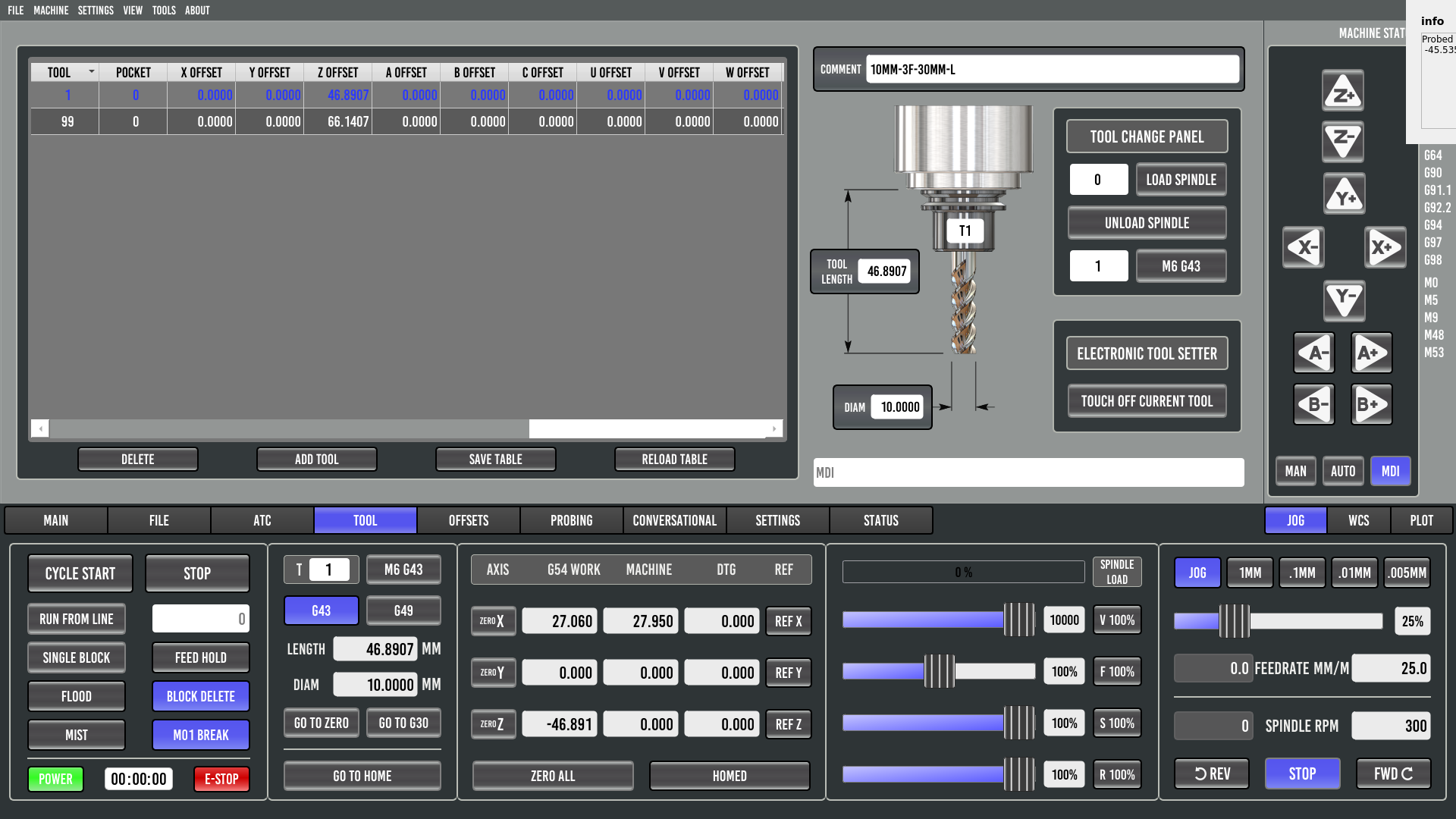

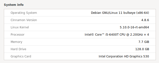

Hello,
I'm running linuxcnc 2.9 on Debian 11(Cinnamon desktop environment) with qtpyvcp and brobe_basic installed from the github source (python3 branches) but I'm having issues with the notification or error dialogues showing almost off screen to the right and cut off when launching probe_basic in full screen mode. My screen resolution is 1920x1080. Are there any settings I can modify to change this behavior?

I believe that issue was just corrected, pull the latest updates and should be resolved!

Thanks, I installed probe basic from GitHub python 3 branch this afternoon, was it corrected later today?

Did you pull the latest qtpyvcp also?

In my case yes and tried again today, no change.
Also quick question: which yml settings file to I need to change to disable error dialogues in the meantime? I modified the one in the probe_basic folder(the folder from which I did the pip install, present in my user home directory) but it doesn’t seem to be having any impact.
