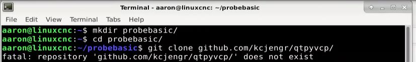

25 Jul 2022 16:35 #248268
by tightmopedman9
Replied by tightmopedman9 on topic probe basic notification dialogues
Thanks for the fix, but I'm not sure how to incorporate it. I see that the fix was in native_notification.py - I was hopeful that I could find this file and port the changes over. After not being able to find the file, I tried to do an update through the probe basic installer with a new repo location of github.com/kcjengr/qtpyvcp/tree/dialogs_fix_py2, but without an update.xml that won't work.
Is there is a document I could check out that would help?

25 Jul 2022 20:18 - 25 Jul 2022 20:19 #248280
by TurBoss
Replied by TurBoss on topic probe basic notification dialogues
Hello tightmopedman9
to get the fixes you may need a git setup
mkdir somedir/
cd somedir/
git clone github.com/kcjengr/qtpyvcp/
cd qtpyvcp/
git switch dialogs_fix_py2
pip install -e .
qcompile -e .
cd ../
git clone github.com/kcjengr/qtpyvcp.conversational-gcode/
cd qtpyvcp.conversational-gcode/
pip install -e .
qcompile -e .
cd ../
git clone github.com/kcjengr/probe_basic/
cd probe_basic/
pip install -e .
qcompile -e .
but if you can wait I'm just installing debian 10 + 2.8 in a virtual machine to test

26 Jul 2022 02:13 #248293
by tightmopedman9

26 Jul 2022 08:00 - 26 Jul 2022 09:03 #248300
by ddB0515
Replied by ddB0515 on topic probe basic notification dialogues
You need to do it properly via git and you have 3 methods:
git clone https://github.com/kcjengr/qtpyvcp.git
git clone git@github.com:kcjengr/qtpyvcp.git
gh repo clone kcjengr/qtpyvcp
Last edit: 26 Jul 2022 09:03 by ddB0515.

26 Jul 2022 14:22 - 26 Jul 2022 17:13 #248329
by tightmopedman9
Made it as far as 'qcomplie -e .', but I'm hitting a 'qcompile: command not found' error now. Fixed by executing the command as sudo and omitting the '-e'.
dialogs fix for 2.8 installed. Testing now.
Generated about 100 errors and all of them were in the correct location, so the fix appears to have worked. Thanks!
