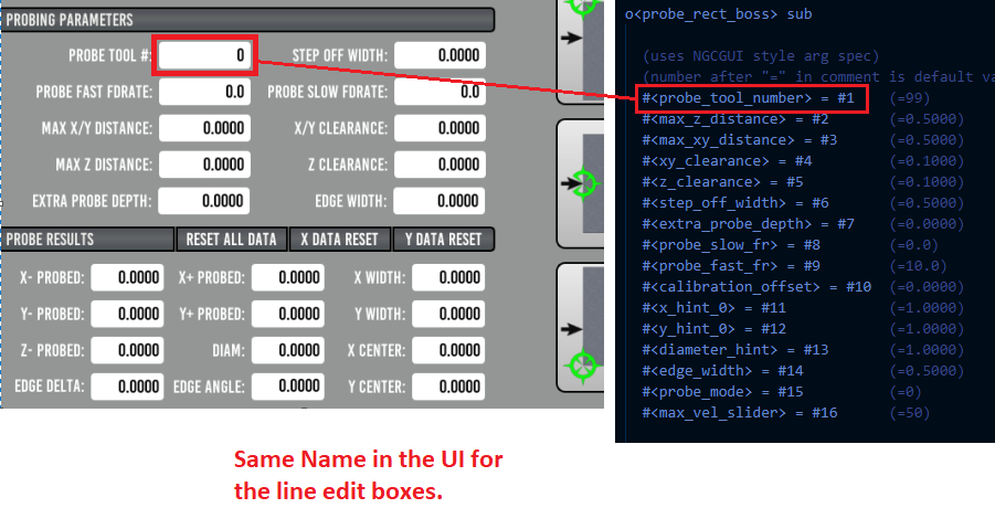

Hi everyone,
I am in the process of migrating to 2.9pre and probe_basic. Thanks to various documents and scripts this went reasonably smoothly. Besides getting to know various buttons and checking their functionality (I have been years with gmoccapy - leaving mostly due to probe_screen lack of compatibility with python3), it is now time for the nighty gritty - the majority of this is related to ATC.
Background:
I have built a 16 pockets carousel tool changer with pulse and index, driven by a cl stepper in velocity mode. It is currently controlled using carousel.comp which I would like to keep with regard to future changes. Making this work with probe_basic's macro structure appears to be some work, but it is straightforward.
In the past, I have used a rack-style magazine and managed the static pocket number using the pocket number entry in the linuxcnc tooltable. While there (at least at the time) was a bug regarding change_epilog export of the current_pocket variable, a work around with a numbered parameter fixed that. Using the pocket number with a rack allowed me to easily change the tools in the rack and edit the tool table accordingly without additional coding. Furthermore, based on the pocketnumber I used to differentiate between different tool pickup locations (e.g. any Pakcetnumber > number of slots: pick up/ drop off tool at a previously defined location for manual tool change). Since I do not want to put all my tools into the new carousel (probe and facemill + extended drills won't fit), I will need to work with the pocket number in the tool table again.
I am thus wondering, what would be the best way to access (read and write) the tooltable from a macro (e.g. write pocketnumber to tooltable). Alternatively, I guess I could write a python script to handle the entire remapping for the toolchange. However, I am a lot more comfortable with ngc macros, as my python knowledge is limited at best.
Do you guys have any pointers?
Side questions to how qtpyvcp and probe_basic work:
-Looking at the code of probe_basic and the way the macros for probing are created with numerous #parameters:
How are these parameters handled and passed on? In the *.ui file, all I see is a reference to the macro.ngc file, but not to a call command specifying which parameters to pass on from input prompts. I guess I am missing something;).

Replied by Lcvette on topic QtPyVCP / Probe_basic - Changing tool table entries from macro or script
ok so for the atc question I'm not sure I completely follow, but if it is just to not have certain tools be stored in the carousel because of fitment, you could easily add a check in the macro that pulls in tool use entered tool numbers that are not to be stored from the UI, or you could manually enter them in the macro if you wanted a quick and simple solution. just have the macro check if any of the tools in the spindle are in the non store tool number list and if so have it prompt for user to manually remove the tool and then click to proceed once tool is removed. as for the carousel comp thing i think spumco was using that and finding his way through it, im not familiar with it but am interested to see it once its up and working and maybe play around with it some then.
for the macros parameters, if you look at the top of the macro file you will see the parameters it is pulling in, they have a:
#<parameter_name> = #1 for example
the #<parameter_name> corresponds to a entry widget container/box/lineedit in the UI with the same exact name that is inside the <>
So in the probing section in the UI for the "PROBE TOOL #" box you will see that in the ui, that lineedit box is named the same as the probing macros parameters that use it.
is this what you were looking for?

Thank you very much. This is precisely what I was looking for. Missed that connection - makes things all the more convenient:).for the macros parameters, if you look at the top of the macro file you will see the parameters it is pulling in, they have a:
