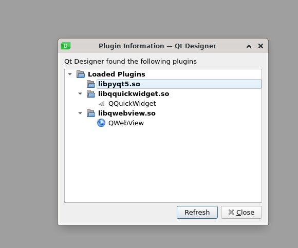

I have my new development machine installed and running Debian bookworm.
Linuxcnc was installed using apt install and is running without issues.
I also installed QtPyVCP and Probe Basic.
When I run the Qt Designer or edit probe basic the libpyqt5.so plugin fails to load. It's looking for libpython3.9.so.1.0 which is not installed.
Instead, libpython3.10.so.1.0 is installed in /usr/lib/x86_64-linux-gnu
I tried setting up a symlink to libpython3.9.so.1.0. That got rid of the load error but the widgets still won't load and I can't get at any rules.
How do I point the plugin to libpython3.10.so.1.0???

29 Apr 2025 02:05 #327269
by emresensoy
Replied by emresensoy on topic QtPyVCP designer plugin fails
I have same issue,
QT5 designer doesnt load custom linuxcnc widgets,
what should I do?

29 Apr 2025 04:22 #327279
by emresensoy
--SOLVED--
with activating on terminal;
source venv/bin/activate
then I run editvcp and select config.yml file
everything is ok now
