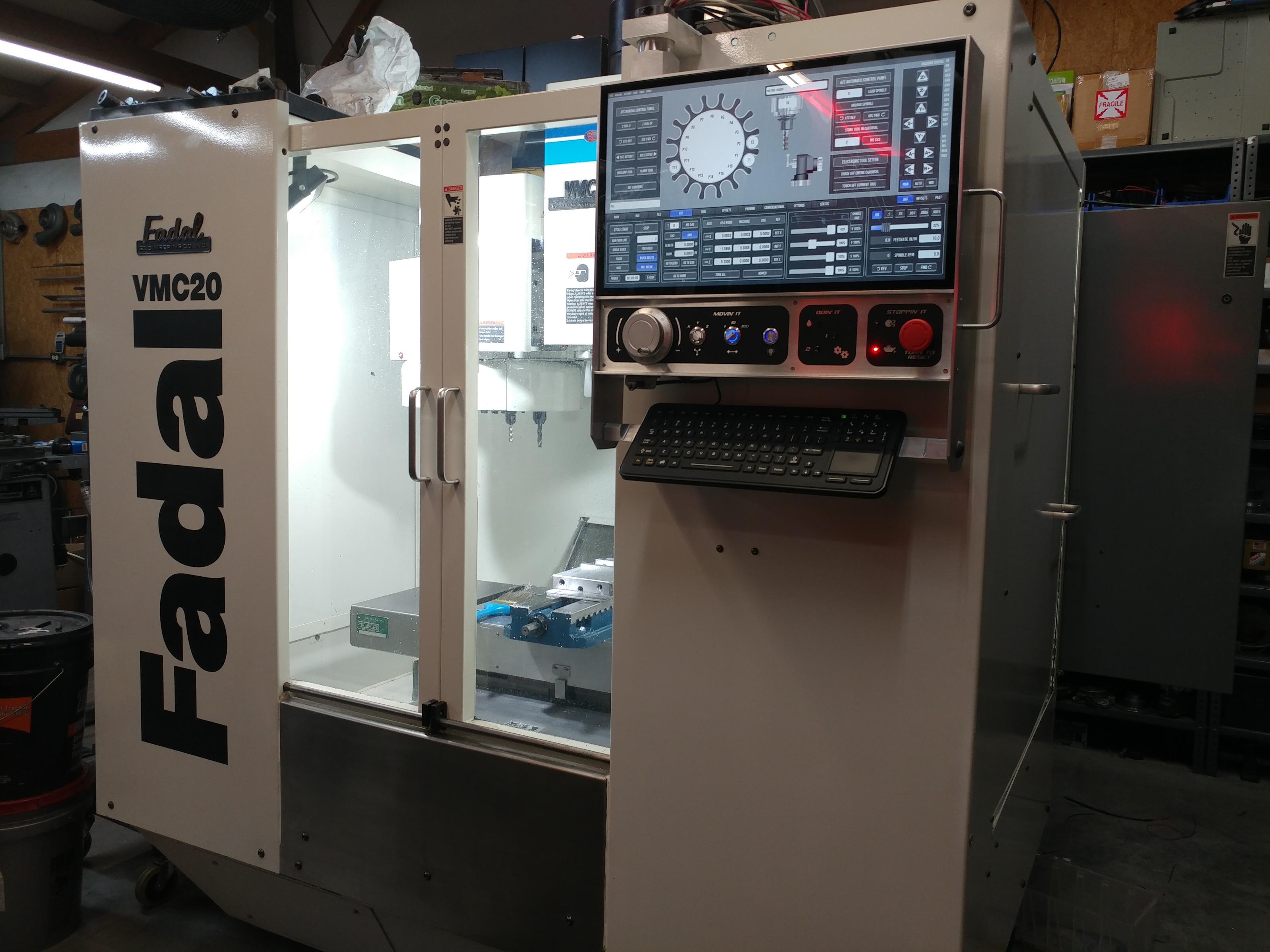

So I have been trying to set up a Fadal VMC20 for lcnc, and we have been making a lot of progress. We are down to the final issue in the ATC config for putting the tool back into the carousel.

We have the machine fully operational now. The lack of documentation and examples for qtpyvcp / probe basic makes it very difficult, yet we were able to get it all figured out.
Some things still mystify me though, like getting the jog increment from the ui, as I added an mpg wheel, and would like the selected increment on the screen to translate to the mpg, but HAL does not expose it.
Also disabling the tool change buttons when it is in auto mode, or when the spindle is turning, then re-enabling them in MDI/Manual mode seems like it should have been an obvious inherent consideration.

I would like the external estop to control the ui software estop button, how do I do this?
This is what I have now
# estop
loadrt estop_latch
addf estop-latch.0 servo-thread
net estop-loopout iocontrol.0.emc-enable-in <= estop-latch.0.ok-out
net estop-loopin iocontrol.0.user-enable-out => estop-latch.0.ok-in
net estop-reset iocontrol.0.user-request-enable => estop-latch.0.reset
net remote-estop estop-latch.0.fault-in <= hm2_5i25.0.7i77.0.0.input-15

I've set PB up to do what you want, sort-of.
net AIR_PRESSURE_OK <= [HMOT](CARD0).7i76.0.0.input-24
net ESTOP_RELAY <= [HMOT](CARD0).7i76.0.0.input-20
net AIR_PRESSURE_OK => and2.0.in0
net ESTOP_RELAY => and2.0.in1
net estop-clear <= and2.0.out
net estop-clear => iocontrol.0.emc-enable-in
#MACHINE-ON WITH ESTOP CLEAR
setp oneshot.0.width 2
setp timedelay.0.off-delay 0.1
net estop-clear => oneshot.0.in
net MACHINE_ON_DELAY <= oneshot.0.out
net MACHINE_ON_DELAY => timedelay.0.in
net MACHINE_ON <= timedelay.0.out
net MACHINE_ON => halui.machine.on
The 'net estop-out' line is not needed, but I can use it for some other estop signaling (flashing light, disco ball, etc.)
However you set your machine up, it's the iocontrol.0.emc-enable-in and halui.machine.on pins that do what (I think) you want.
Nice Fadal, BTW. And really nice panel.

Thank you Ralph, but on my machine the the halui.machine.on synchronizes the estop and machine on buttons to work together, is this how yours functions? I would like my external e stop to turn on and off the UI estop button.
It does turn it off when I hit the the external estop, but when I reset the external one, I must manually reset the button on the UI. Not a huge deal but I have another machine with QT Dragon and it does just that.
