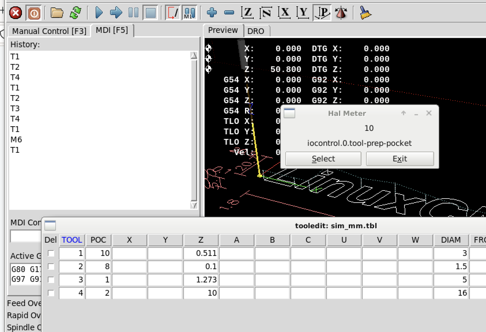

25 Oct 2022 23:22 #255066
Replied by andypugh on topic Tweaked Probe Basic UI fails to launch
The iocontrol.0 pins seem to work properly.
And the stdglue routines use find_tool_pocket.
github.com/LinuxCNC/linuxcnc/blob/2.8/nc...glue/stdglue.py#L100
I just ran the sim/axis/remap/rack_toolchange config, and initially T1M6 picked up a tool from close to the origin. Editing the tool table to put T1 in pocket 10, then reloafing the table, made the same T1 M6 command move a lot further from the origin for the change.

26 Oct 2022 04:54 #255077
by spumco
Replied by spumco on topic Tweaked Probe Basic UI fails to launch
I feel like I'm hijacking the OP's thread, but I'll plow on...
Andy,
It's certainly possible I'm doing something wrong with an M6 remap. But in the stdglue.py file the comment under "M6 remap" section indicates it's intended to expose tool_in_spindle, selected_tool, current_pocket, and selected_pocket.
Could you run the rack toolchange sim again and do the (DEBUG, the value of current_pocket is #<current_pocket>)?
What I know is that using the bog-standard stdglue.py (as well as the one in the Probe Basic sim) resulted in the pocket number never being passed to carousel (through toolchange.ngc). And every time I ran the magic comment to check the value of #<current_pocket> I got a ###### error.
Which would also explain the stdglue file top comment:
Andy,
#NOTE:# The legacy names *selected_pocket* and *current_pocket* actually reference# a sequential tooldata index for tool items loaded from a tool# table ([EMCIO]TOOL_TABLE) or via a tooldata database ([EMCIO]DB_PROGRAM)Please Log in or Create an account to join the conversation.
