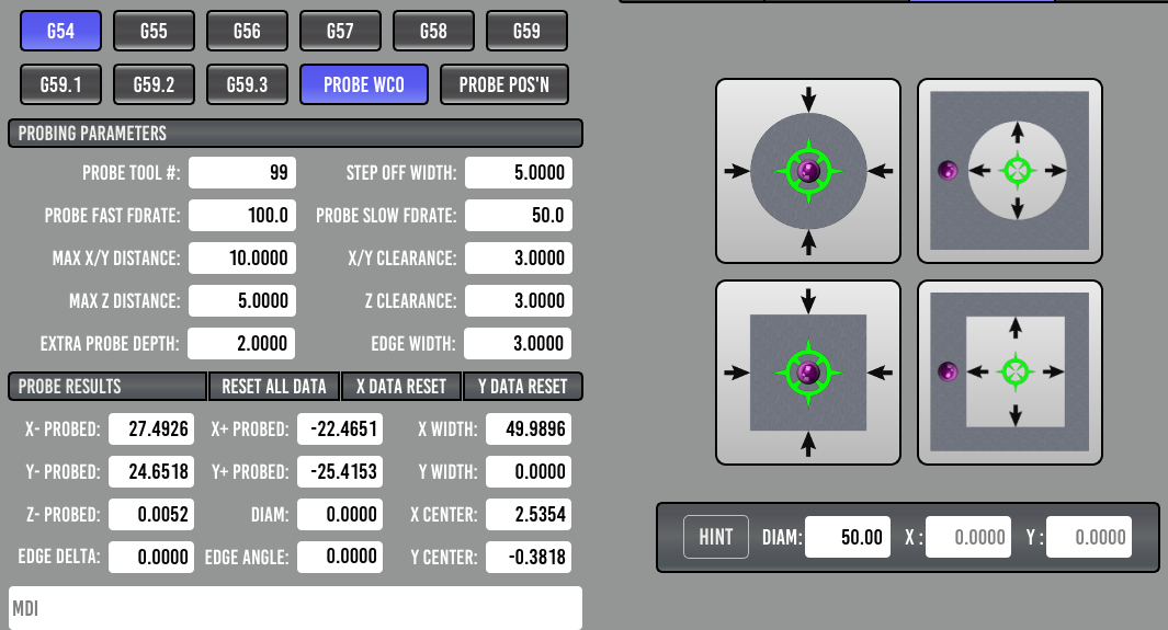

Probe Basic Error: Probe tipped during none probe move was created by anton610

Hello,
thanks!
when i invert the input pin, probing does not work.
the half or a few more moves of the boss probing routine works, then i get suddenly the error.
best regards anton
thanks!
best regards anton

Hello!
Thanks for the inputs!
I get the error only at the last few mm, before the probe tips the workpiece. During the fast moves i get no error. Really crazy problem.
And sometimes it works. Yesterday after 15min of boss probing it worked but i had to repeat it a few times.
Thanks!
Thanks!
