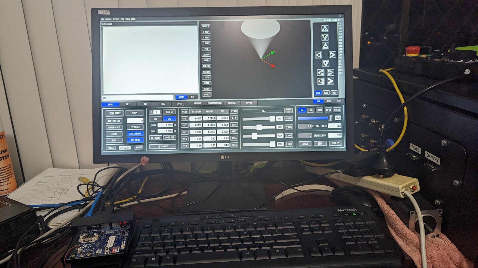

22 Mar 2023 06:54 #267298 by rodw
Tested and confirmed working on Armbian OS and Odroid N2+  (with 6 core ARM CPU)
Long way to go with Armbian yet, but this means this script should also work on the Pi and other CPU's supported by Debian.
Th Odroid PC is shown to the left of the keyboard
The following user(s) said Thank You: tommylight, Lcvette

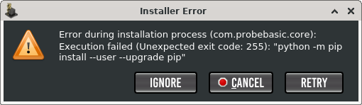

09 May 2024 07:20 #300220 by Dragonick
I tried to install with ProbeBasic installer 0.4.0 run. This error pops up. Is there a solution for this?
09 May 2024 14:34 #300237 by Dragonick
Stupid mistake, everything is clear.
For posterity, the problem occurred while installing debian. The problem was adding the root password during installation.
09 May 2024 22:15 #300279 by rodw
This is OK but you need to add a new user and then add that user to the sudoers group.
