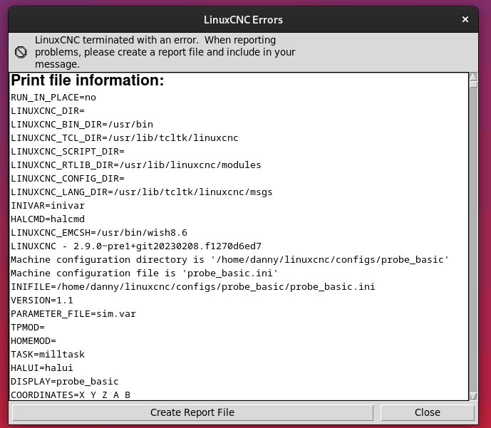

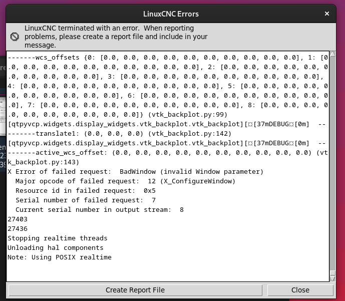

Hey guys thanks in advance for any help with this. I'm in the process of building my first CNC machine; I'm familiar with CNC machines but not as much with linux, so I may just be missing something obvious.
LinuxCNC is running fine, latency seems good, and I was able to communicate with the MESA Ethernet board. Opening other QtPyVCP GUI's such as QTdragon works fine, but when I try to open a Probe Basic sim or custom config it crashes before anything is displayed.
I originally set everything up on Debian Buster with LinuxCNC 2.8.4, but after having no luck with that and thinking it may be a Python 2 / Python 3 issue, I re-installed with Bookworm and tried a few different installation methods for Probe Basic but I'm still getting the same error.
I'm thinking maybe this is due to not running it in a virtual enviorment? Would I need to install it inside a virtual enviorment or is there another way? Running a virtual enviorment seems like it would be less robust, but I'd love to hear otherwise if that's the case.

I tried to add the crash log here but it wouldn't let me for some reason. I'll put it in a comment.Please Log in or Create an account to join the conversation.

Got it working!
Seems like it was from using Gnome instead of the supported XFCE, and wayland was casuing the error. Disabling wayland did the trick and all is working now on Gnome.

This is correct. Linuxcnc does not like wayland so xfce (an Xorg system) solves the issue
There have been changes recently to the code and it seems to be OK here on Debian Bookworm installed deba.
adding this line to your .profile file in your home folder should also fix it after a logout/loginRef: github.com/LinuxCNC/linuxcnc/issues/2264
export PYOPENGL_PLATFORM=x11Please Log in or Create an account to join the conversation.
