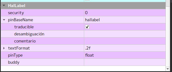

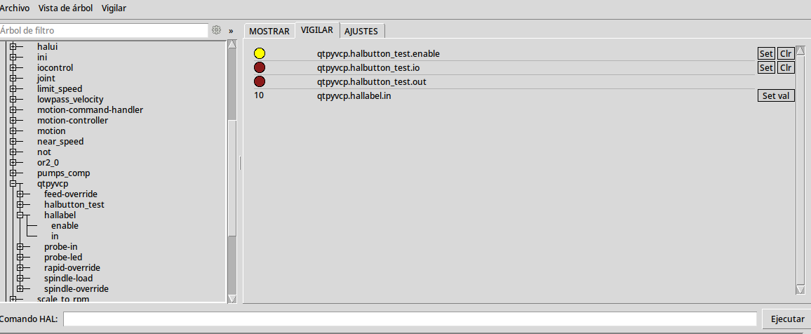

Hello,
you can try to change the hal label from the halshow tool under tools/halshow
pins -> qtpyvcp -> myhallabel -> in
by goin to the watch tab and click the "in" element of the tree will add it to the list and show some buttons

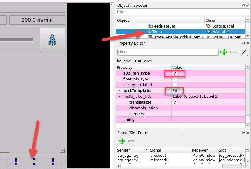

the label has diferent types that need to be the same type returned by %QW10 thats a s32 so need to modify the properties if the hal label in the designer by click on the hal label and press "Ctrl+i" the scroll down and set the pin type to s32
you should also need to fix the text format

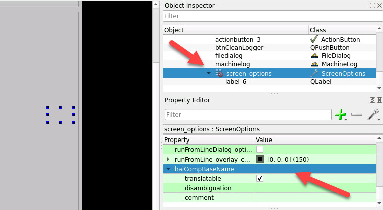

1) add hallabel in the gui
2) change the name of object as you want, in my example "lblTemp"
3) specify the correct datatype (thanks TurBoss)
4) decide if specify or not the pin_name, finally in the hal you should point to the label name if empty, label name.pin_name if specified
5) Create a postgui hal file if not already used (thanks KCJ)
6) IMPORTANT! check in the screen_options object in your gui the "halCompBaseName", if empty, you should use the ui file name
I can imagine, by default here there was "qtpyvcp", I don't know.. but in my case, leaving empty it, you should consider the ui name, otherwise you can specify a custom name.
7) finally, in the postgui hal file, add the link: "net WaterTemp => AG_CncHmi.lblTemp" because my ui file is called AG_CncHmi.ui

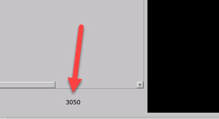

This is the result!
Thanks a lot
Andrea
