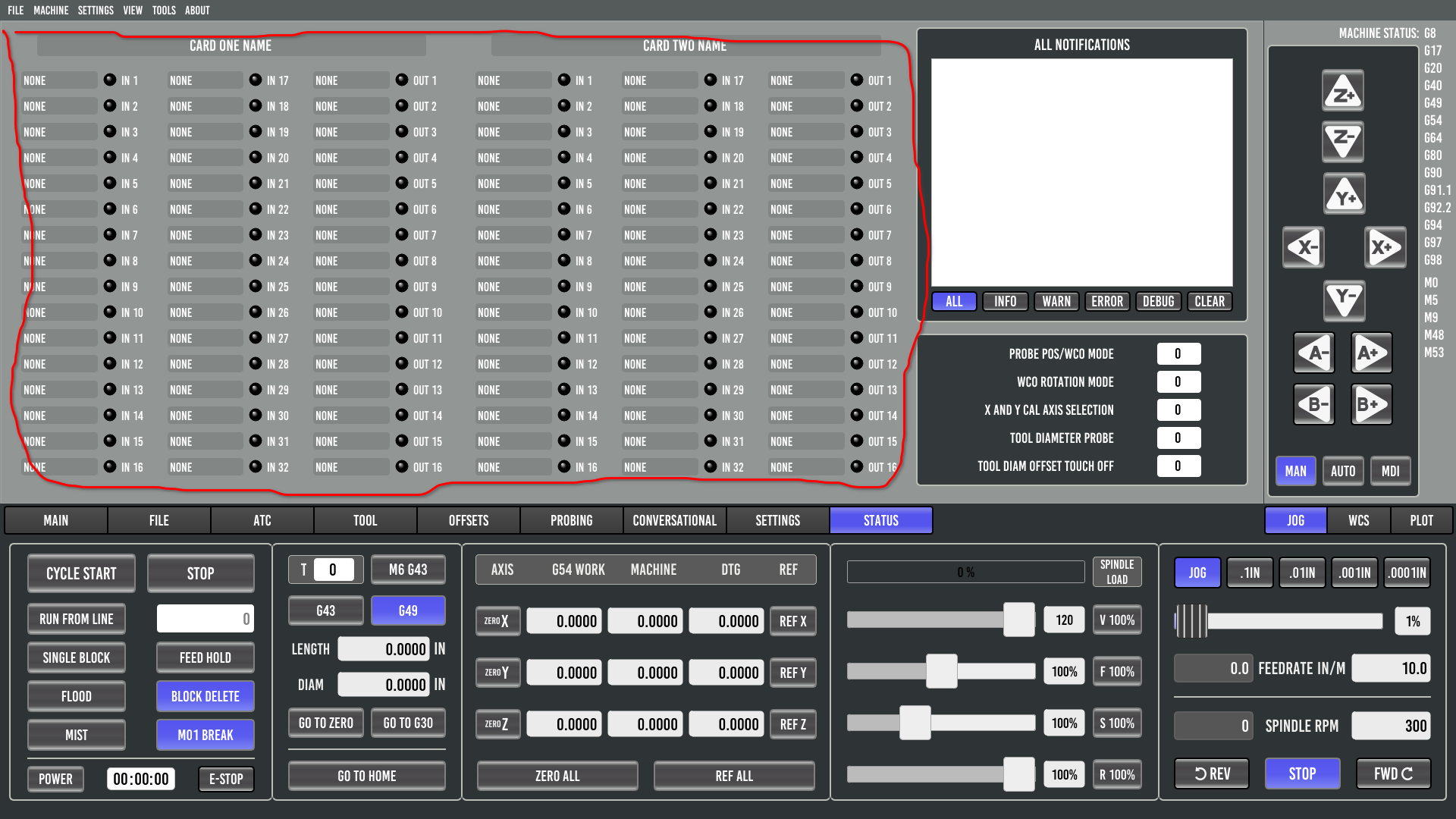

I have Bookworm 6.1.0-10-rt-amd64 and LCNC 2.9_pre1 installed. I used the instructions at
kcjengr.github.io/probe_basic/quick_start.html
to install PB. I noticed that the I/O screen that I had when running 2.9_pre0 on Bullseye is missing in this new version. Does anyone know how to get that back and the file that links that page to the actual I/O?
Thanks,
Brandon

As an additional note, when I first encountered this issue last week, the status screen was not completely empty but had a "Test Button" button in the middle. When I started getting things reinstalled, I noticed that the button was gone. I did some searching and it looks like the button was removed five days ago. I'm curious if others are having a similar issue. 80+ views seem to indicate maybe so. I am not sure if there is a way to load an older version that still had this feature.

The io page was removed due to some issues it was creating. We removed from the main version until it can be resolved. Being it was just a convenience and that same data is available via Halshow, we may or may not add it back to the main version.

I liked it too, and I could imagine a later version might have user-input fields to name the IO without having to go 'backstage' in QT editor.The io page was removed due to some issues it was creating.
What issues did you see?

adding so many update requests created a pretty big hit to latency.
