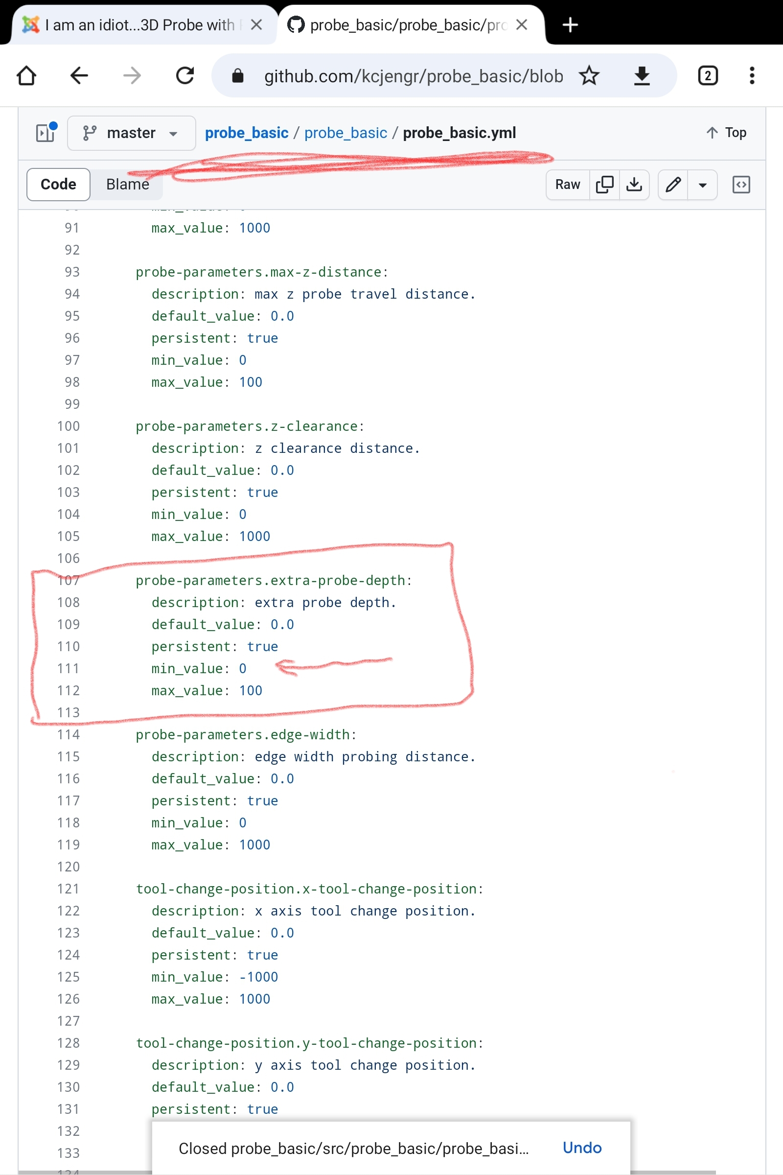

Mine is already quite puny at 0.078". If I knew where to change the code to let it accept a negative number, I would make the change myself. Is the input text box set to only allow for positive numbers, because it removes the leading negative. If that were the case it may be an easy fix.

Depending how you installed probe basic you may or may not have access to the probe_basic.yml file.  If you do,  you can do the following:
Change the min value shown in the file below to:
min_value: -100
The following user(s) said Thank You: msrdiesel

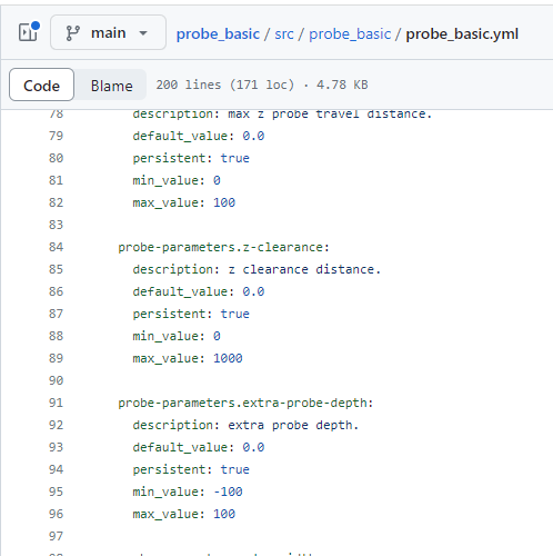

14 Aug 2023 02:52 - 14 Aug 2023 02:54 #277905 by Lcvette
Replied by Lcvette on topic I am an idiot...3D Probe with Probe Basic
I was able to test the change recommended above and confirmed it does now accept negative entries in the extra probe depth user entry.  the change has been pushed to the latest version, for 2.8.4 you will need to manually update it in a dev installation.
