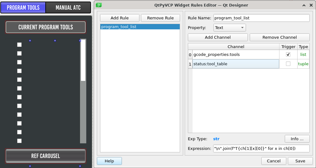

23 Dec 2023 12:43 #288904 by Lcvette
Replied by Lcvette on topic BUG REPORT ATC TOOL LIST
we recently added a program tools list that populates on program load. for some reason having a B0.0000 move breaks it but not sure why. with B0.0000 only the first tool is populated in the program tools list. remove the B0. and starts working again... very strange.
23 Dec 2023 13:14 #288906 by Lcvette
Andy,
These are the widget rules we are using.  It works great when the G0 B0. is not in the program. not sure why that would cause an issue though.
The following user(s) said Thank You: CNC_ANDI
23 Dec 2023 14:08 #288908 by dpslwk
Replied by dpslwk on topic BUG REPORT ATC TOOL LIST
the issue in in qtpyvcp
gcode_properties.py
class PropertiesCanon(BaseCanon):
    def get_axis_mask(self):
        return 7  # XYZ
the `gcode.parse()` on line 423 is throwing an error
which i think is because PropertiesCanon is using t fixed axis mask, which mean it's refusing to process the B move, since its been told to only expect XYZ moves
