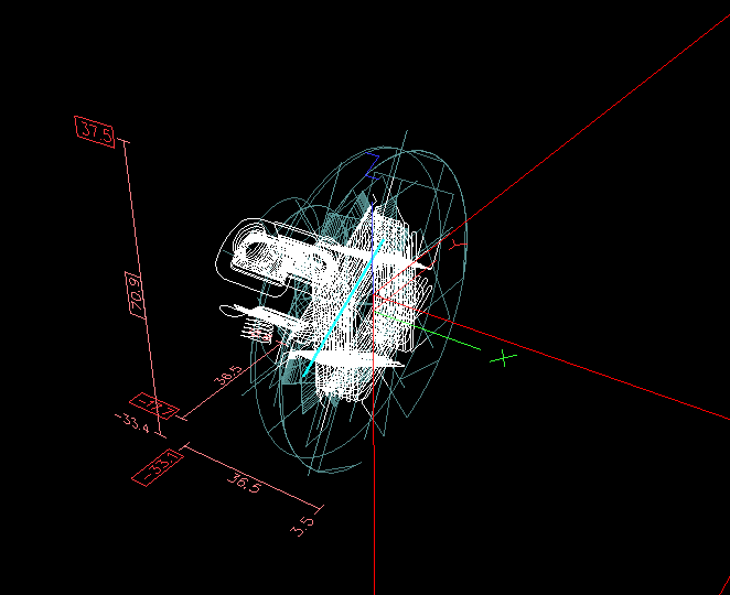

Probe Basic 4th Axis plot
- anton610
- Posts: 40
- Thank you received: 7
22 Jan 2024 10:33 #291329
by anton610
Probe Basic 4th Axis plot was created by anton610
The following user(s) said Thank You: CNC_ANDI
- Posts: 4819
- Thank you received: 2176
23 Jan 2024 17:20 #291440
Replied by Aciera on topic Probe Basic 4th Axis plot
Maybe this:
In the DISPLAY section of your ini file:
GEOMETRY = A!XYZ

23 Jan 2024 18:21 #291443
by anton610
Replied by anton610 on topic Probe Basic 4th Axis plot
Many thanks!
I'll try

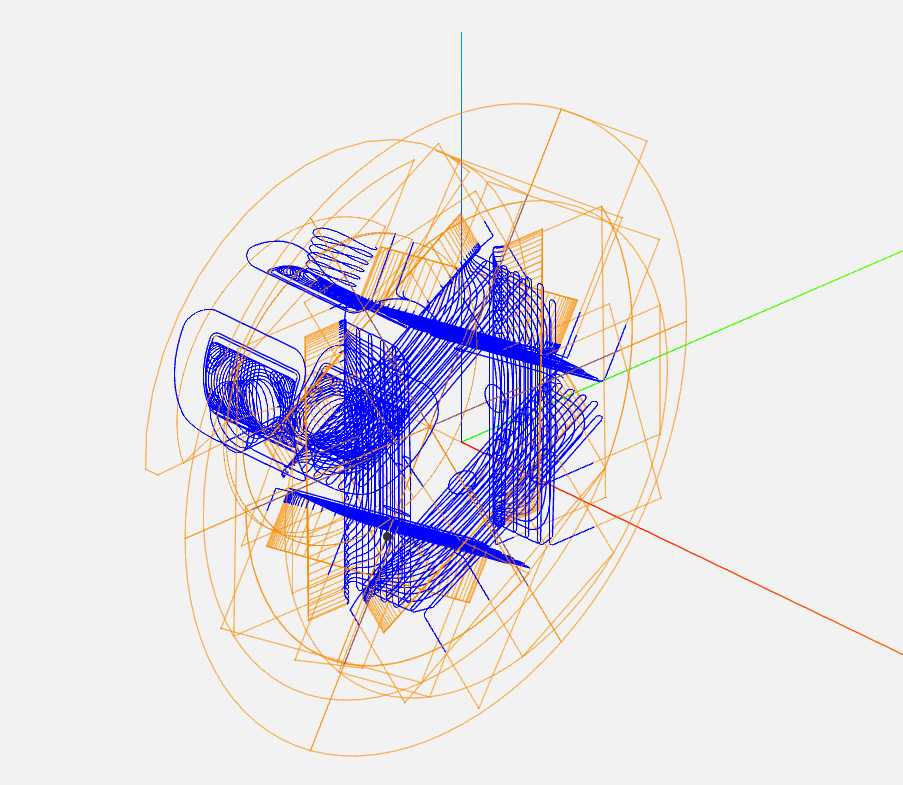

23 Jan 2024 19:14 #291448
by anton610
- Posts: 4819
23 Jan 2024 19:37 #291454
Can you post the gcode for that?

23 Jan 2024 22:05 #291472
by anton610
Hello, thanks for your reply, here is the gcode:
- Posts: 4819
24 Jan 2024 07:18 #291497

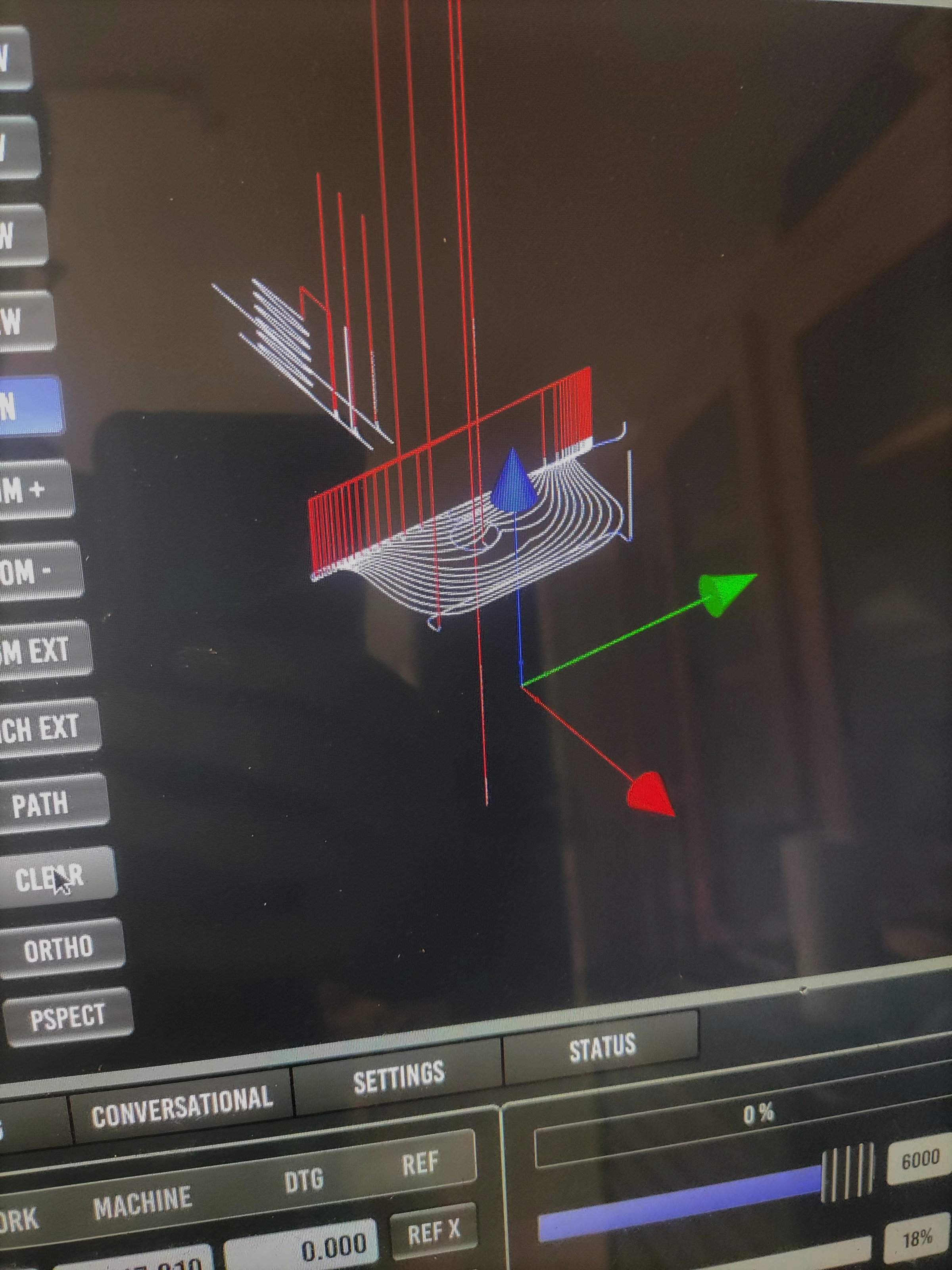

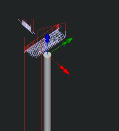

11 Feb 2024 10:03 #293070
by anton610
Hello,
I'm on 2.9.2
but still no 4th axis plot.
Do i have to change anything else?
Thanks!
I'm on 2.9.2
Thanks!
- Posts: 4819
11 Feb 2024 10:15 #293073
Have you changed the 'GEOMETRY' string in the [DISPLAY] section of your ini file?
