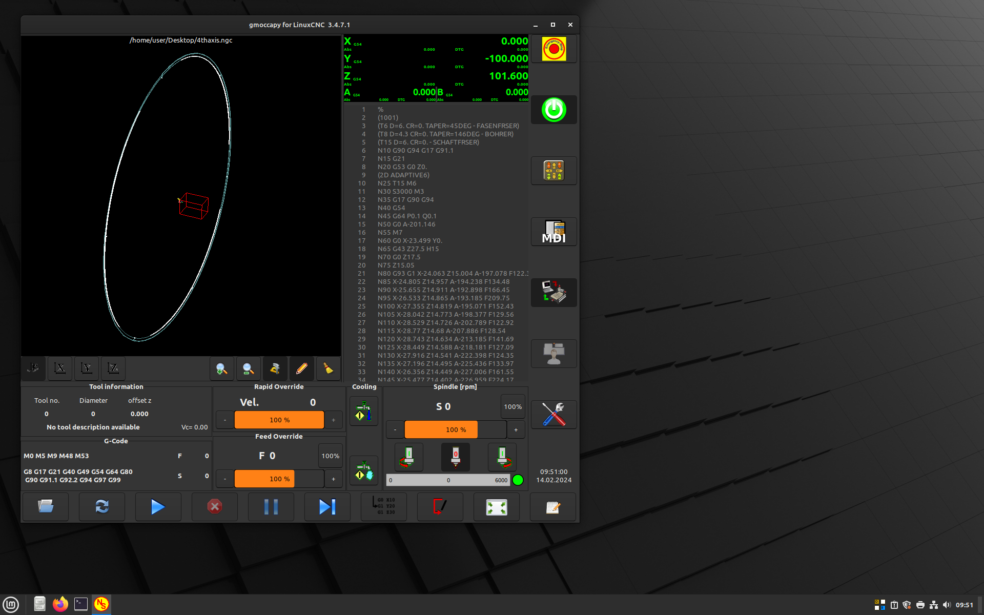

Yes
A!XYZ
A!XYZ
Last edit: 11 Feb 2024 12:42 by anton610.

Rereading the documentation makes me wonder if the exclamation mark should be before rather than after the rotational axis letter.
Maybe try:
!AXYZ
Experimental: If the exclamation mark (
) character is included in the GEOMETRY string, display points for A, B, C rotations respect the X, Y, Z offsets set by G5x, G92 codes. Example: Using!for a machine withGEOMETRY = !CXZ. This provision applies for liveplots only — G-code previews should be done with zero G5x, G92 offsets. This can be facilitated by setting offsets in programs only when task is running as indicated by #<_task> == 1. If nonzero offsets exist at startup due to persistence, offsets should be zeroed and preview reloaded.[TRAJ]COORDINATES=XZC
Maybe try:
!AXYZ

Hello, no success
BR anton

Not sure what your are doing but I just tried on 2.9.2:
1. Added this to the [DISPLAY]-section of 'configs/sim/gmoccpy/gmoccapy_XYZAB.ini'
2. start the 'gmoccapy_XYZAB' simulation config
3. open the ngc from your post here: forum.linuxcnc.org/qtpyvcp/51447-probe-b...-plot?start=0#291472
I get this (the work offsets would need to be adjusted for proper preview as I mentioned before)
I just notice that you are using 'ProbeBasic'. I'm not familiar with that gui as it is an external project but maybe that has got something to do with it not working on your installation.
GEOMETRY = A!XYZ2. start the 'gmoccapy_XYZAB' simulation config

Hello,
No, I didnt resolve it.

mine do not work too....
!BXYZ
!BYXZ
on a older version of Probe_basic or Linuxcnc (i dont know) it worked well...
!BXYZ
!BYXZ
