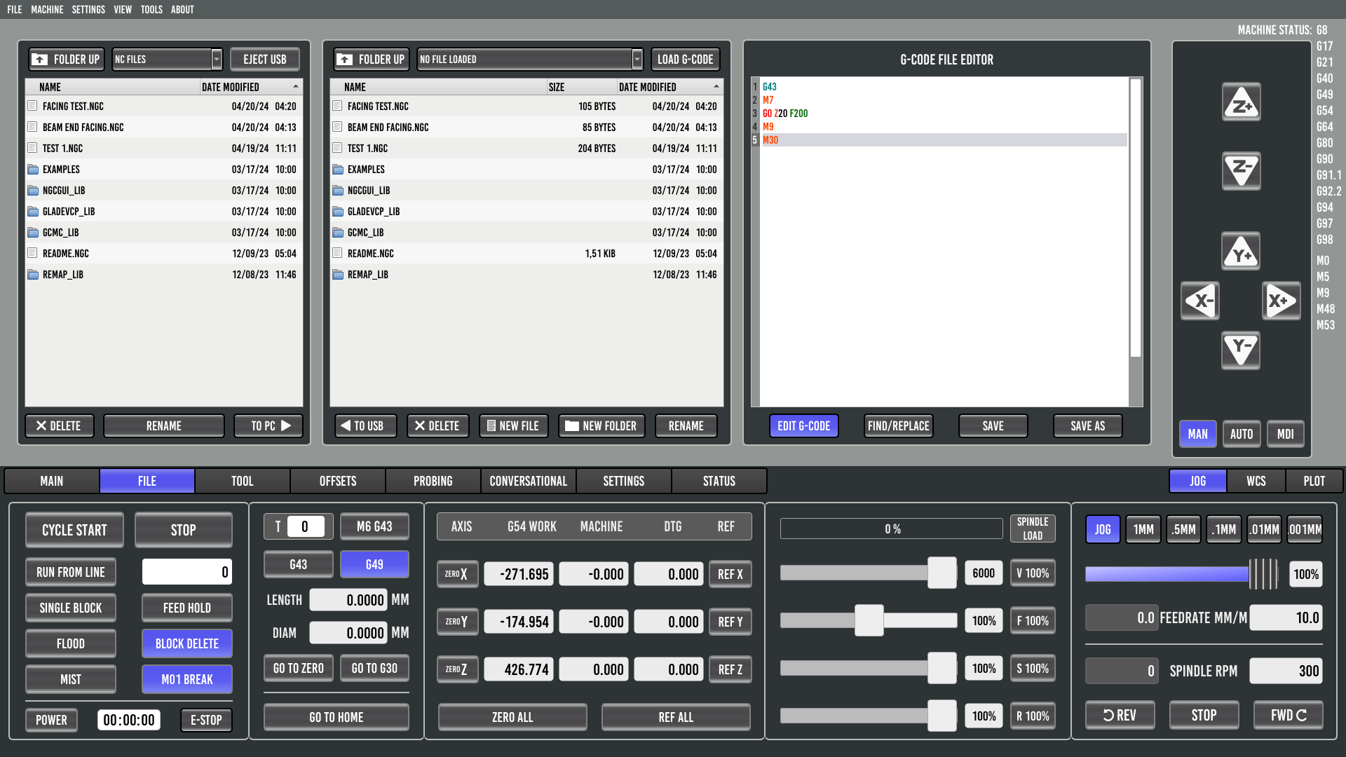

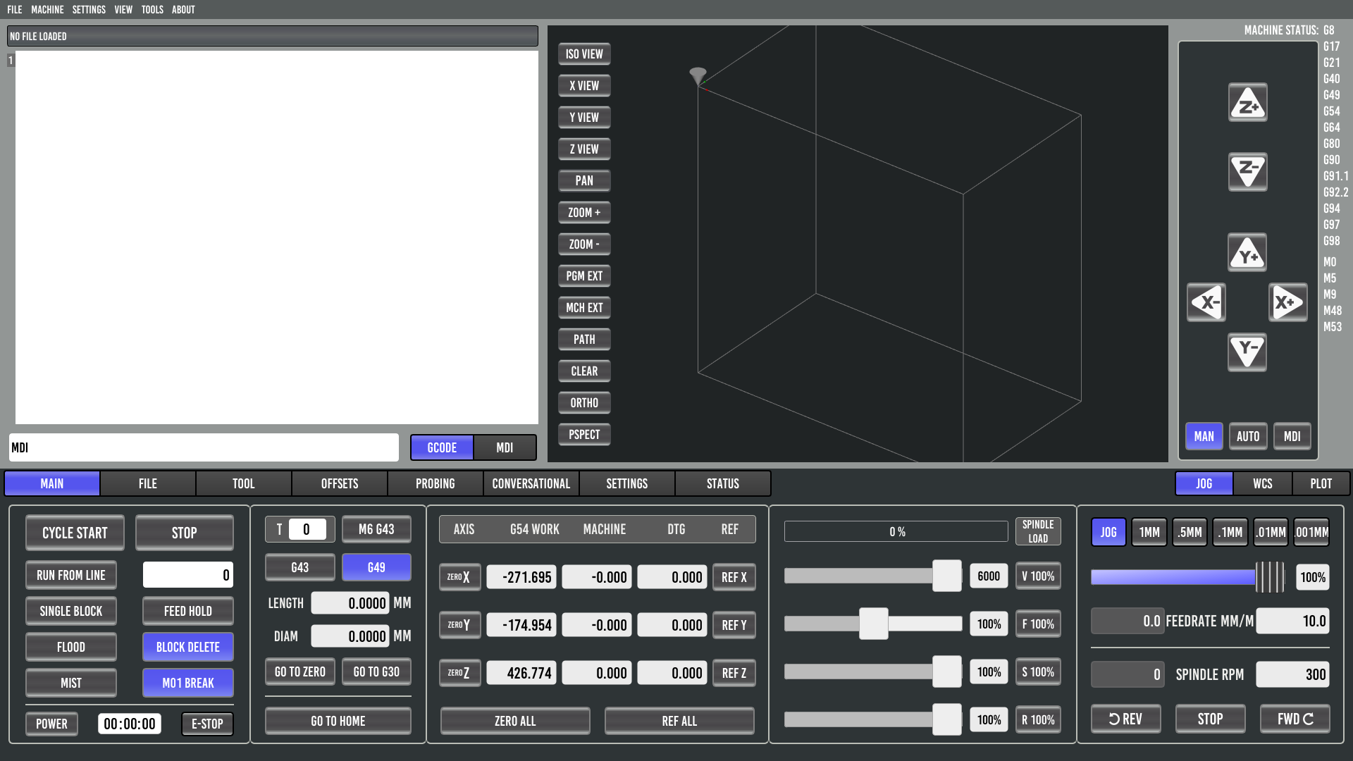

I'm running the latest stable version of LinuxCNC 2.9.2 on a fully updated Debian 12.5 install along with the latest ProbeBasic updates and I've come across some issues relating to syntax highlighting and file handling.
If I fire up ProbeBasic and start typing in the G-code editor under the File tab I get this very nice syntax highlighting seen on the screenshot below.

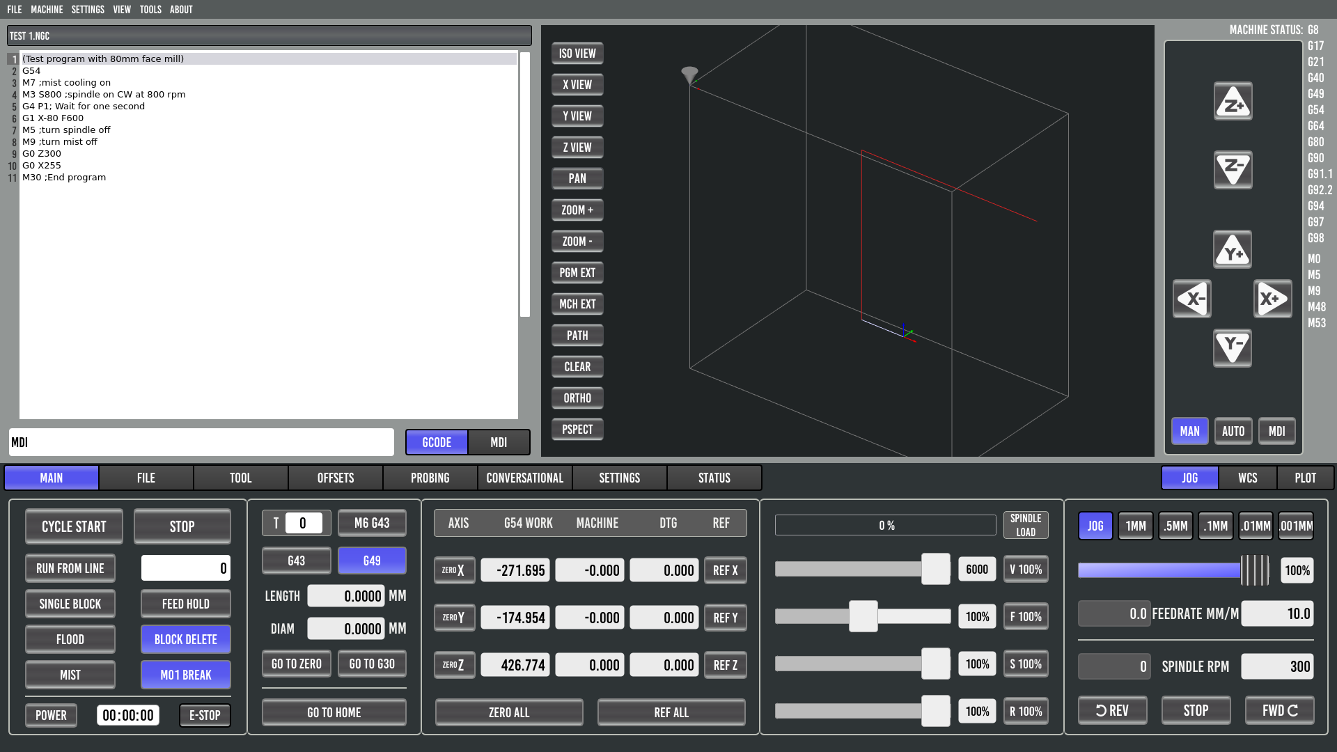

However if I press the "Save" button nothing happens. If I press the "Save as" button a dialog prompting for a file name appears but the file doesn't actually seem to get saved anywhere and the G-code doesn't get loaded into the "Gcode" preview under the main tab (as seen on the screenshot below).

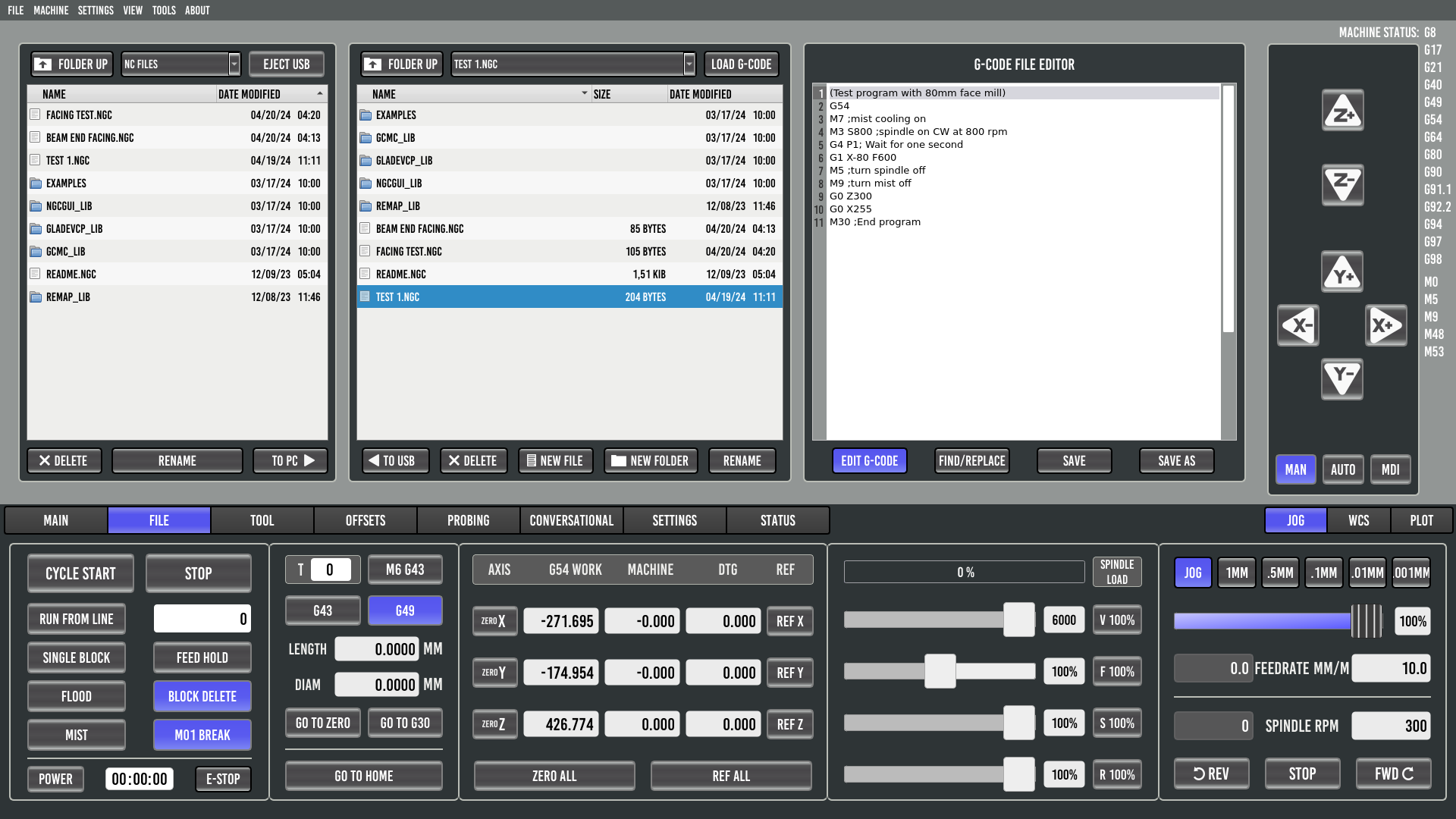

If I instead load an existing file using the "Load G-code" button under the File tab the selected file is actually loaded and displayed both in the G-code editor and "Gcode" preview under the main tab. However now the nice G-code syntax highlighting is gone.
These are not show stopping issues but I thought I'd bring them up to get the attention of the developers.
If you want me to create a GitHub issue just let me know and I'll add one.
I'm getting the same behavior in the simulator so I haven't attached my LinuxCNC ini/hal files.

Changing the file extension to .nc did change the icon of the files in the file browsers but it still doesn't give any syntax highlighting.
Think I found the classes responsible for the syntax highlighting and file editing in the QtPyVCP GitHub repository. But at first glance I don't see anything obviously wrong.

I dug further into this issue yesterday and while I didn't manage to figure out the syntax highlighting issues I did however notice that the "Save as" button actually works when you start with a blank previously unsaved file.
It's just that the filename dialog that pops up doesn't have any path set so if you just type in a filename the file is saved relative to where the config is located for the current LinuxCNC session. I think a more user friendly approach here would be to prefill the path to the directory currently displayed in the file manager to left of the G-code editor.

I noticed this the other day also, I have it on my list to address. If you enter a path to save it works but it could certainly be easier than typing a full path out. If you have a fix already please let me know and submit a pull request and I'll have a look and incorporate it after testing,
Thanks!
