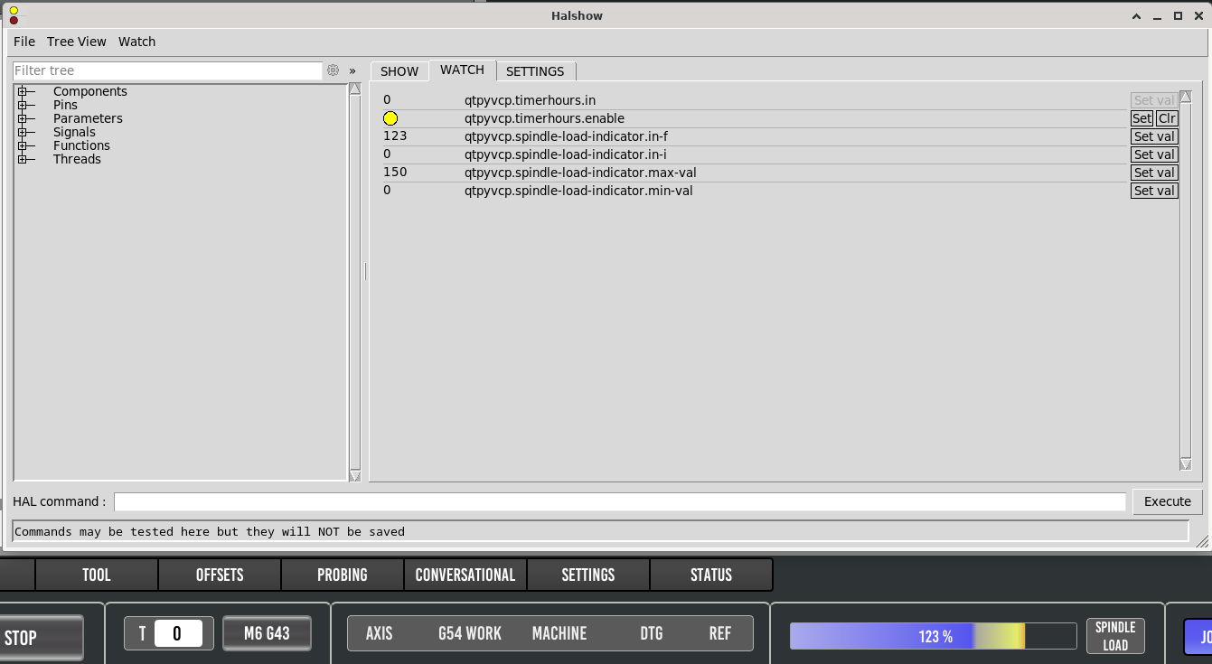

Hi there,
that's my first post here as I came to obstacle and need some support. Installed latest LinuxCNC and configured probe basic. Now there is a field "Spindle Load" which should read value from:
qtpyvcp.spindle-load-indicator.in-f
I can find it in halshow and even manualy write some value.
Now need to connect some value here, let's say from ladder:
net sp_ld qtpyvcp.spindle-load-indicator.in-f <= classicladder.0.out-01

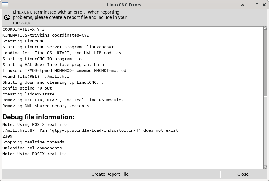

but this results in crash:
./mill.hal:87: Pin 'qtpyvcp.spindle-load-indicator.in-f' does not exist
How to make qtpyvcp pins available in hal file? Or there's another way to write spindle load to qtpyvcp?

Put that in postgui.hal file, not in the main hal, probably those pins are created by GUI so when trying to load from the main hal, they still do not exist.
This is just a guess.

Put that line in file probe_basic_postgui.hal as it was defined in INI file and now it works!
