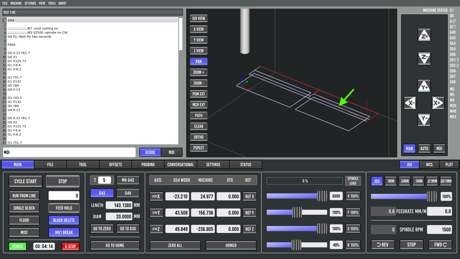

Today I made my first CNC program using multiple work offsets (G54 & G55) and noticed that the preview in Probe Basic doesn't match the actual path of the program.

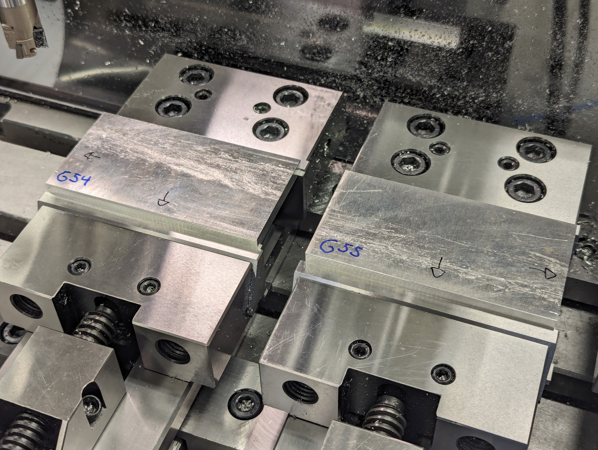

I have two pieces of stock setup in two vices next two each other with the work offsets probed to the lower left corner of each piece (ignore the black arrows, they are only there for my reference as the parts are mirrored).
I've written a program that does all the operations on the left part first in offset G54 and then switches to G55 and does the operations on the second part.
The preview of the program in Probe Basic adds a line across the second part when switching offset (highlighted by the green arrow).
I scratched my head for a long while trying to figure out what was going on as that line shouldn't exist. Eventually I disabled the spindle and inverted the Z values of the program so it would run just above the parts. When I run the program it run's as expected. It finishes the first part with the end mill located right between the two pieces. It then switches offset and resumes work on the second part without going across the part.
I'm a rookie when it comes to G-code so it might be something in my program that's confusing the preview but I thought I'd mention this here to get some input from the more experienced LinuxCNC users.

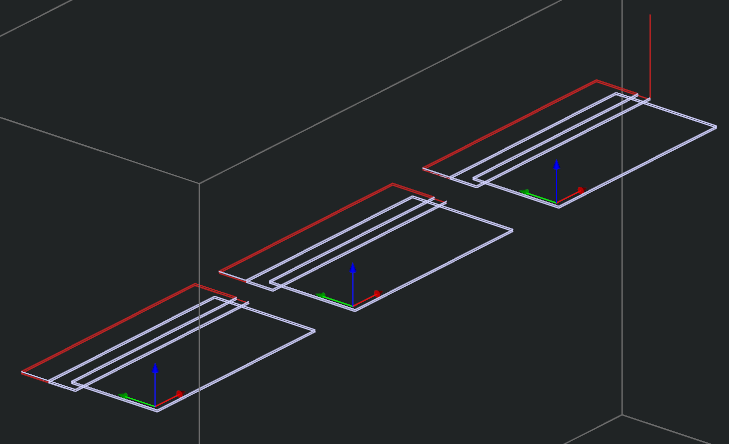

07 May 2024 01:27 #300004 by Aciera
Replied by Aciera on topic Preview doesn't match actual program path
Not sure as I do not use PathPilot but testing your gcode on my regular LinuxCNC install I cannot reproduce this.
This is what I get with G55 X-offset = 150:
07 May 2024 02:44 #300010 by Unlogic
Replied by Unlogic on topic Preview doesn't match actual program path
Your preview in PathPilot looks exactly like what I expected the preview in ProbeBasic would show.
I dug further into the issue yesterday and it seems that if you are at position X100 Y100 in G54 and switch to for example G55 the plot automatically goes to X100 Y100 G55 even though the machine actually hasn't moved at all.
This causes the first move done i G55 to be incorrectly represented in the preview as the starting point of that line will start in the wrong place.

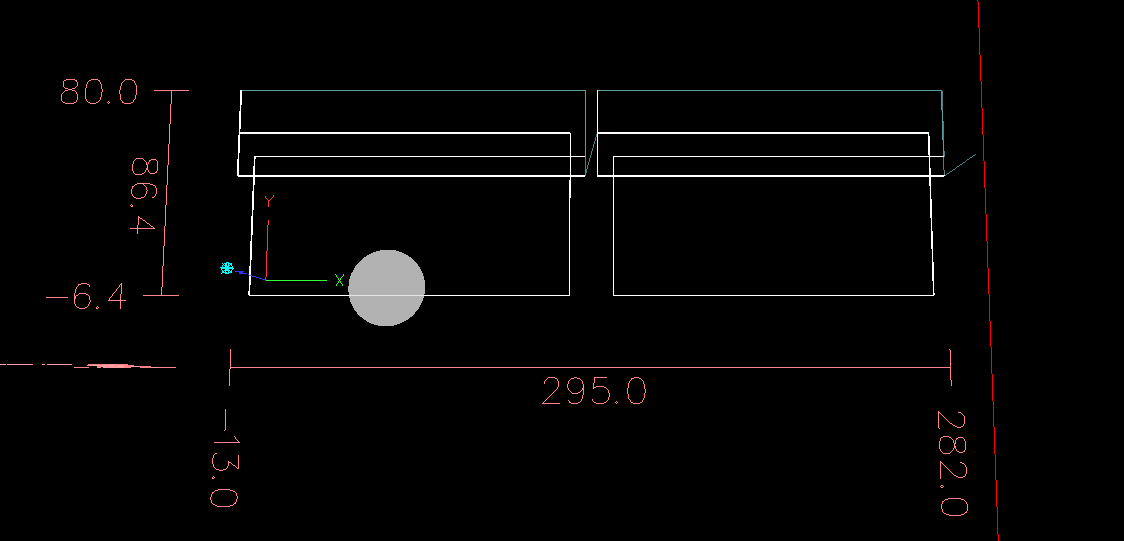

07 May 2024 04:19 #300021 by Aciera
All I see when switching from G54 to G55 is the coordinate system origin moving to the right:

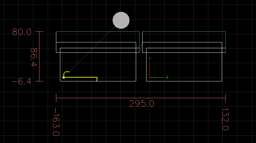

09 May 2024 18:15 - 09 May 2024 18:19 #300252 by TurBoss
Replied by TurBoss on topic Preview doesn't match actual program path
hello, thanks for the report
and yes there is a bug in the plotter
I'll add a quick fix to hide the wrong lines while I figure how to draw the rapids between each path
Thanks!
Last edit: 09 May 2024 18:19 by TurBoss. Reason: add a picture

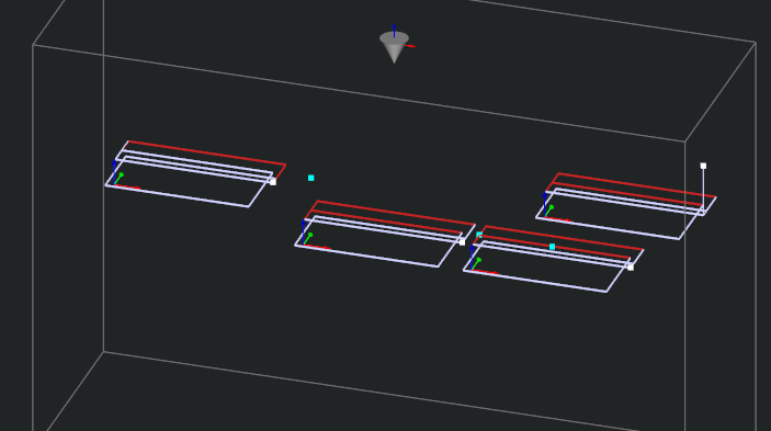

13 May 2024 03:54 - 13 May 2024 03:55 #300495 by TurBoss
made some progress :)
I hope get it working soon
Last edit: 13 May 2024 03:55 by TurBoss. Reason: forgot the screenshot
