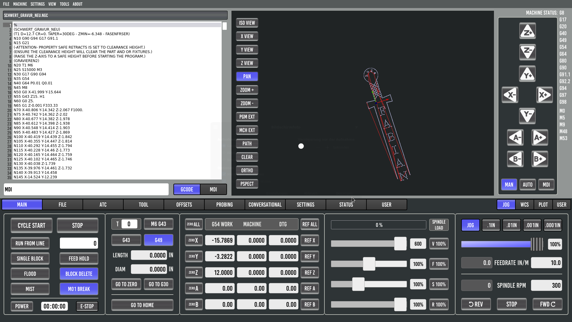

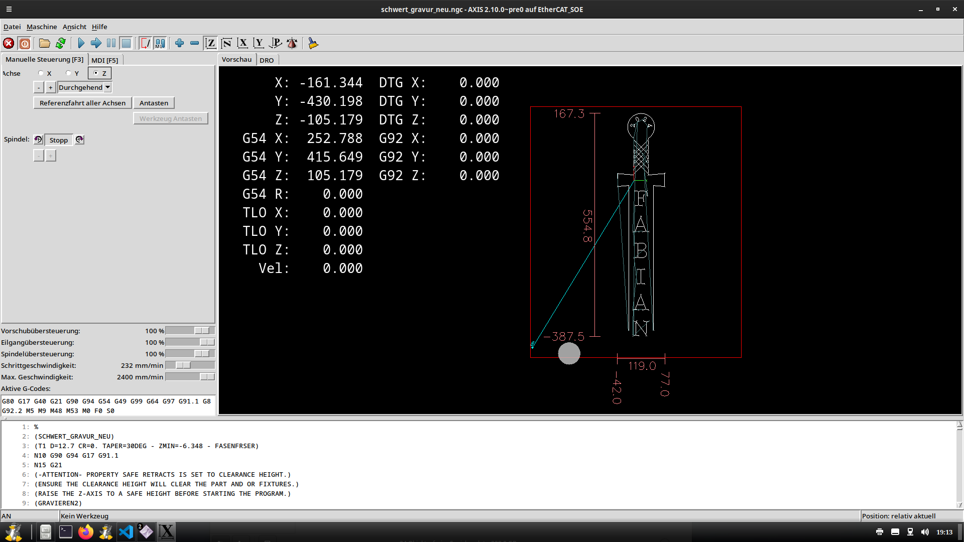

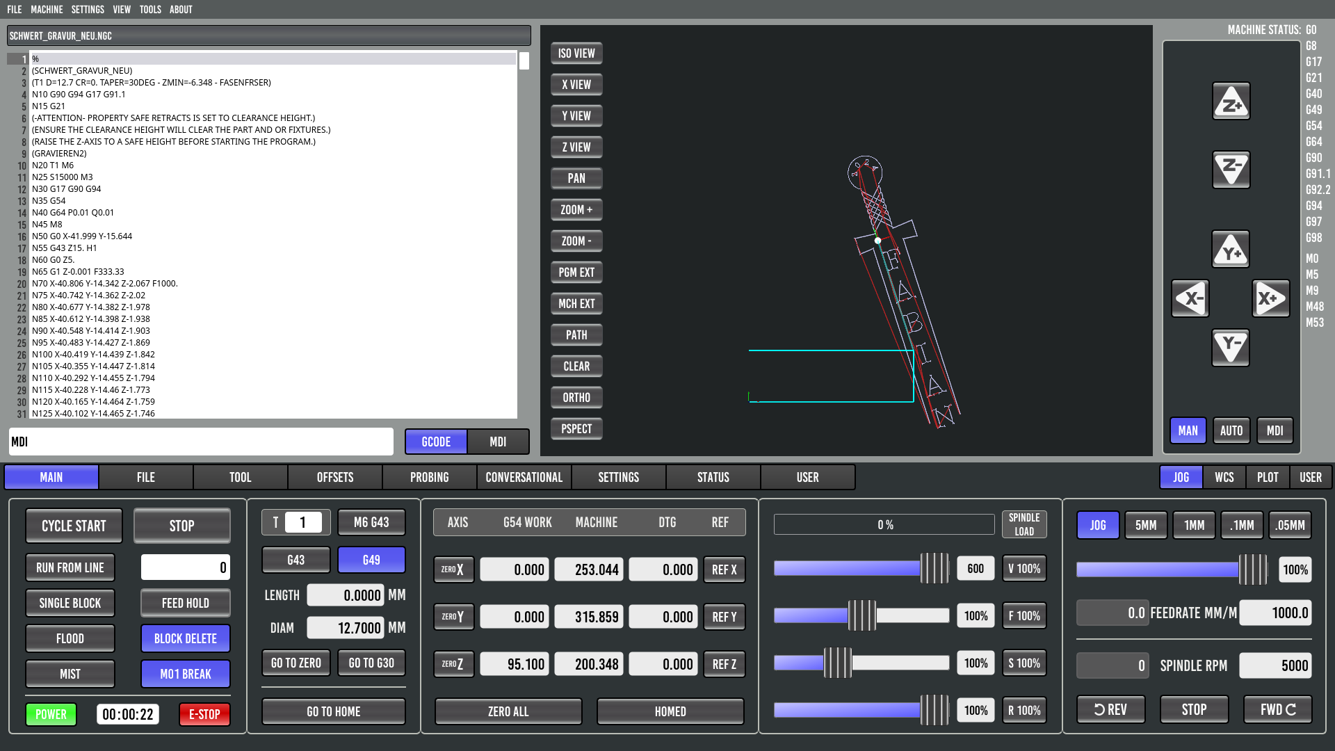

Hi, i recently have setup ProbeBasic as Screenset.
Managed to get my configuration migrated to work with probe basic. The machine can get out of EStop, Enabled and Homed. I also can jog the axes in all directions.
But when i load a gcode file, plot of the file is rotated on the Y-Plane between 10 and 15 degrees.
When i run the program the AXES are moving as the Plot shows. (See Screenshots)
If i load the same file in AXIS the directions are correct, and the movement also.
Sim Machine
What can be the Problem?
Sim Machine

23 May 2024 09:05 #301205
by Lcvette
Replied by Lcvette on topic Probe Basic Rotation of WCS ?
do you have a rotational work offset set?, check the offsets page and look under R column to make sure it is zeroed out.
