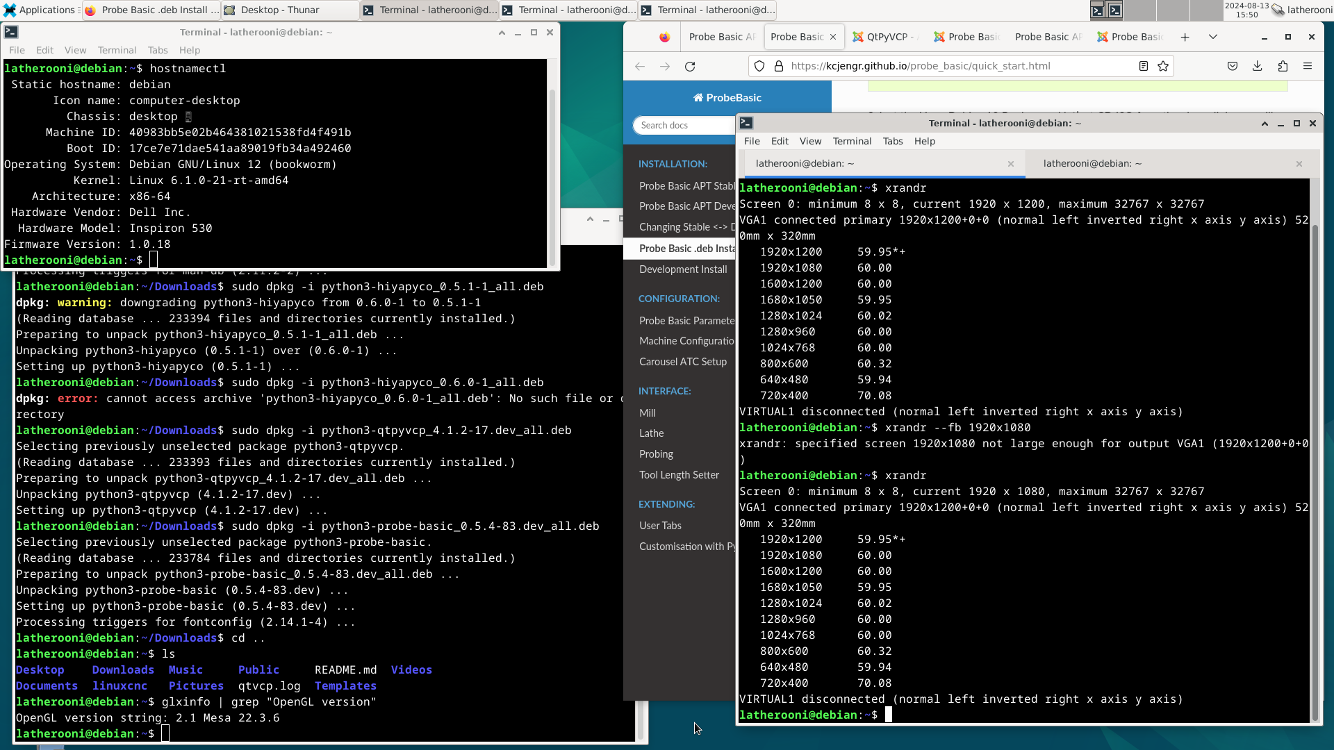

hi,
I'm running into issues running the probe basic simulator. I first tried the APT stable and then the probe basic.deb install (both resulting in different errors)
- What Linux OS being used including kernel type?
debian 12 (bookworm)
Linux 6.1.0-21-rt-amd64
- What version of Linuxcnc is installed?
2.9.2
- What version of QtPyVCP and Probe Basic is installed?
QtPyVPC_4.1.2-17
Probe-Basic 0.5.4-83
- How did you install Probe Basic? Quickstart guide? Dev Guide?
Probe basic .deb install (kcjengr.github.io/probe_basic/quick_start.html)
- Have you gone through your ini and hal files and compared to the sim config files to make any changes needed?
n/a - simulator broken
- Have you added all of the necessary files in your config folder that probe basic needs to run?
n/a
- Have you tested the sim version to see if the problem exists there also? (if the sim functions properly, it is a good indicator your issue is in your config)
yes - error report attached
- Add specific details and circumstances surrounding the issue or your question. The more details the better!
using a dell insprion 530, i've tried using an NVIDIA quadro k620 as well, but ran into driver issues
error message after .deb install:2024-08-13 15:25:38.813 ( 17.105s) [ 4A454040] vtkShaderProgram.cxx:438 ERR| vtkShaderProgram (0x514b550): 0:1(10): error: GLSL 1.50 is not supported. Supported versions are: 1.10, 1.20, and 1.00 ES/usr/bin/linuxcnc: line 977: 5077 Segmentation fault
system info in screenshot, errors in deb install txt file
Thank you for all of the resources so far, and thanks in advance for the help!

Your pc is to old, see the requirements at the top of the installation docs, it states the minimum opengl requirements for vtk which is the backplotter used in probe basic and qtpyvcp uis. Can use a graphics card to resolve or a newer pc.
