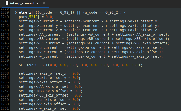

09 Sep 2024 16:27 - 09 Sep 2024 16:58 #309757 by Aciera
Replied by Aciera on topic Probe Basic subroutine parameter - #5210?
If one interprets the explanation of #5210's function as being "disable G52 & G92 offsets", then it's perfectly appropriate to use it they way they did.
I certainly hope there is no such wording in any of the documentation.
[edit]
As an illustration here is what 'G92.2' does (setting #5210 happens in this line 'pars[5210] = 0.0;'):
Last edit: 09 Sep 2024 16:58 by Aciera.
09 Sep 2024 18:21 #309767 by spumco
Replied by spumco on topic Probe Basic subroutine parameter - #5210?
I think it's not painfully obvious - at least to me.  The G-code Overview section:
[i]5210[/i] - 1 if "G52" or "G92" offset is currently applied, 0 otherwise.
I think it's possible to misinterpret that statement.
Not until you dig deeper in other sections of the manual is the behavior a bit more clear.  From G-code/Coordinates/G92 Persistence Caution (5.3):
...where 5210 is the [i]G92[/i] enable flag (1 for enabled, 0 for disabled)...
I think the solution is to remove the #5210 parameter, and add G92.2 to the very beginning of the toolchange sequence, and G92.3 to the very end.  That way any offsets used in a program are restored and not just erased after a tool change.
