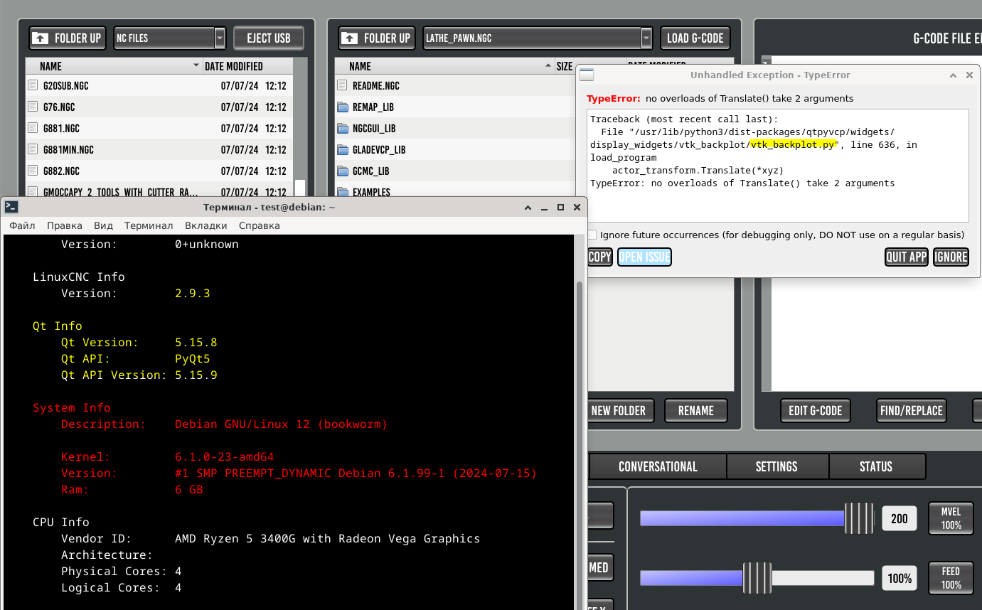

probe_basic_lathe vtk_backplot.py error
- iMaks-RS
- Posts: 3
09 Sep 2024 07:54 #309717
by iMaks-RS
probe_basic_lathe vtk_backplot.py error was created by iMaks-RS
error if open any .ngc turn file.
how to disable or change backplot to "standart" - as axis interface?
mill probe_basic - ok.

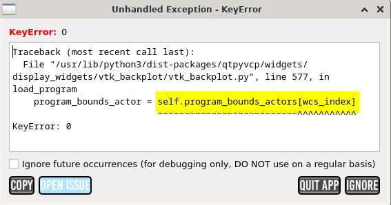

Updated the system today, including ProbeBasic from version 0.5.4 to version 0.6. The error is still there, but the error message is different.
Is the lathe version tested by anyone before release? If so, on what configuration?

need more information on your build, what debian version what kernel version etc... the sim here is working as expected so i would assume the issue is a compatibility problem you are experiencing perhaps or maybe the custom_config.yml file needs to be updated.
have you tested using the simulation version of probe basic?

we found the lathe backplot error and the fix is on the latest develop version push, if you are on the develop version and run an update, should resolve. if on the stable version a new release will be coming today or tomorrow which will resolve on the new and updated stable branch.
