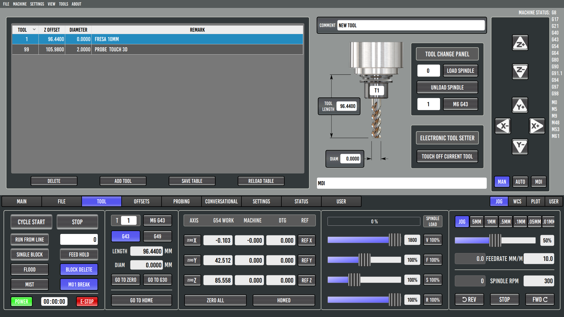

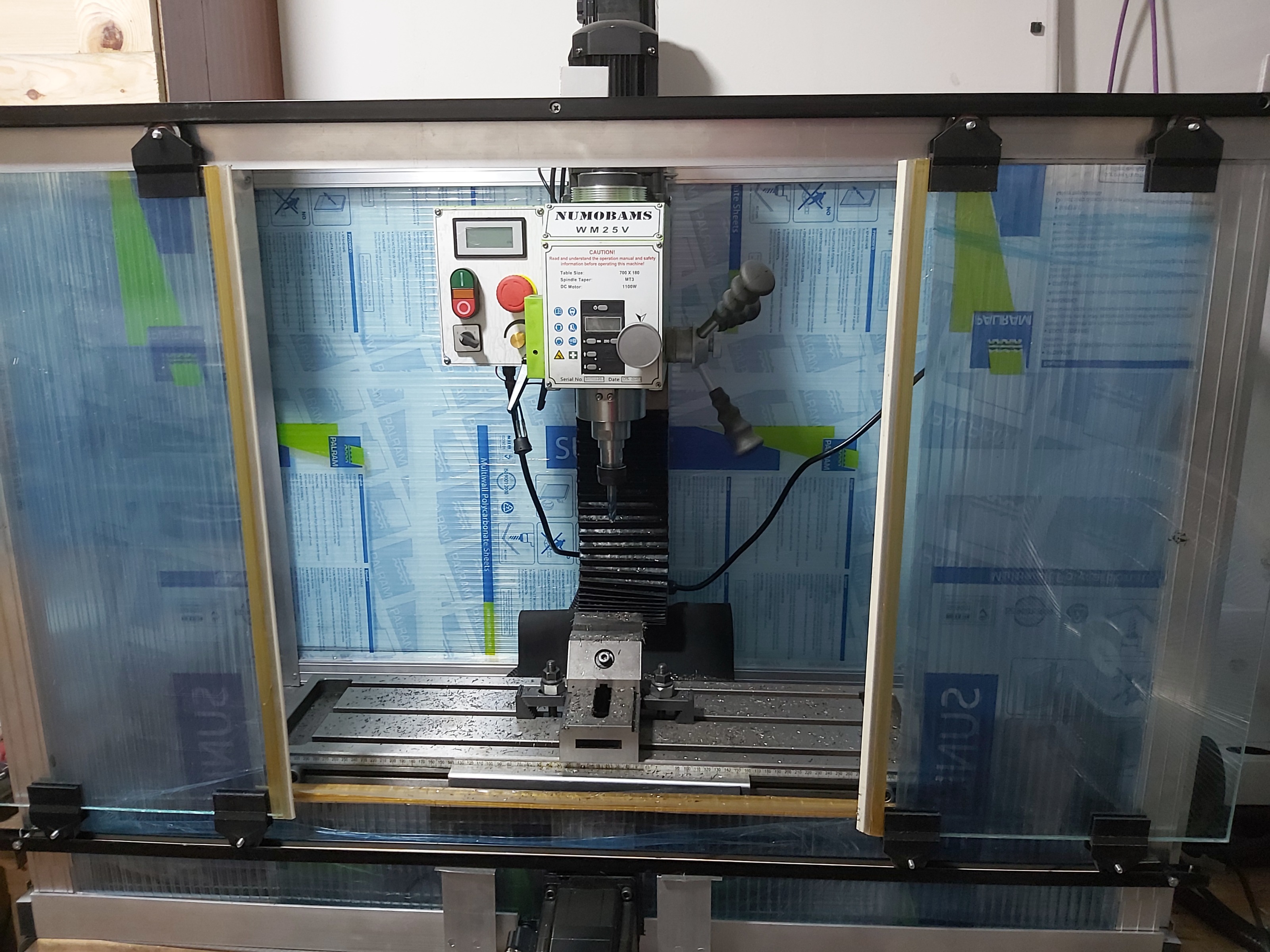

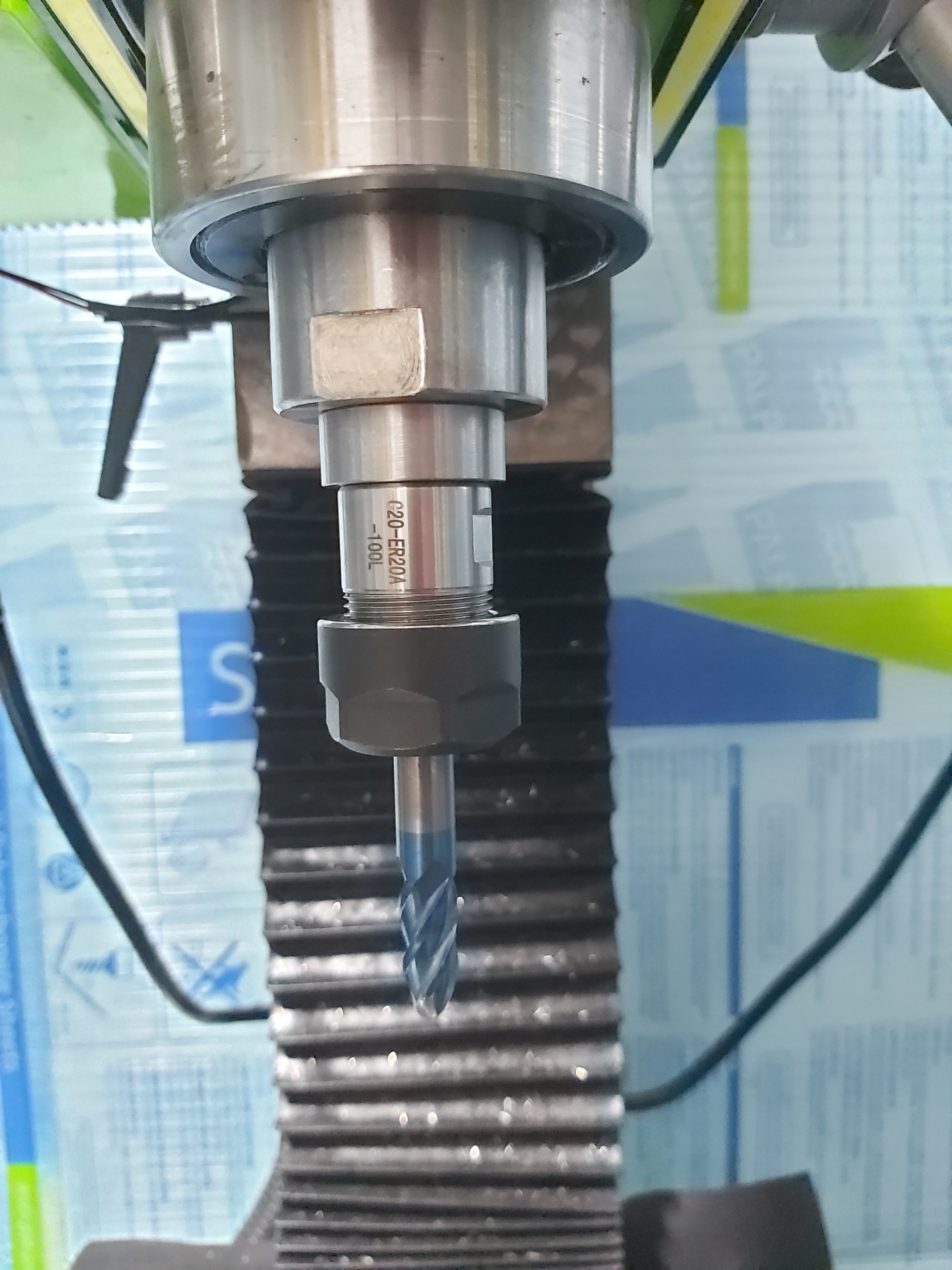

My milling machine is PM25MV but with a different name. The spindle is MT3, I also had the option of R8 but at the time of buying it I didn't know which one was better. I have the option of buying the R8 spindle at some point and changing it. (I think I will do it in the future).
I use ER20 tool holders with an MT3-20mm collet, I have modified them so that they maintain the height. I have checked it and it has a repeatability of 0.035mm +-.
I configure the tool displacement by touching the spindle without tools and marking Z0, then I put the tool (3D probe) touch the same point (I use a thin paper to feel) and I enter that distance in the table with the corresponding tool, and so on with the others.
I enter the diameter of the 3D probe in the table, but for the other tools I enter the diameter in Fusion 360.

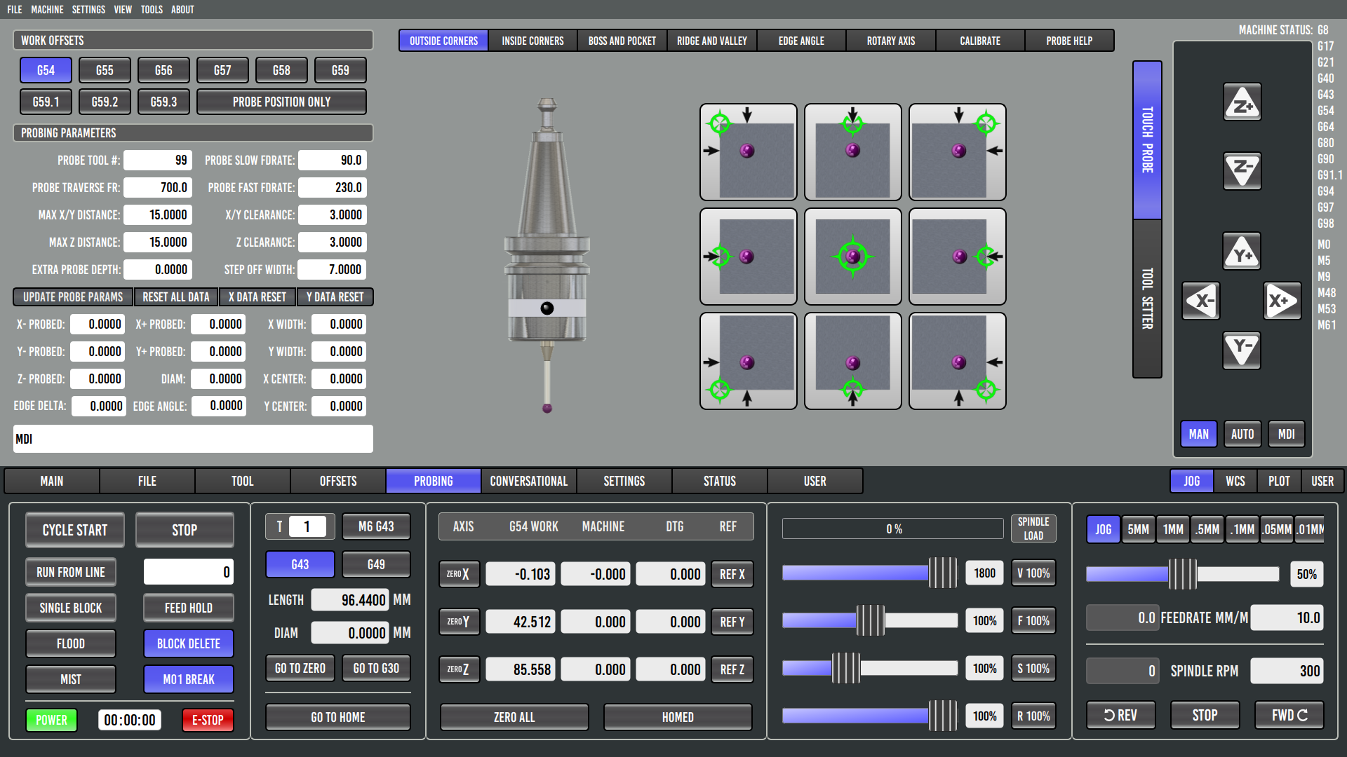

Ok so you are using the probe as a master tool. I would advise against that, if you crash the probe you mist remeasure all tools after resetting the probe stylus with your method. Follow the method in the docs for best results so all tools measure from the spindle nose gage line. Then only the tool crashed or replaced requires remeasuring.
kcjengr.github.io/probe_basic/probing.html#probing-setup

I have tried to follow the steps in the link you posted but with the translation to my language it is a bit confusing for me.
What I have done is:
With the spindle nose I have reached my jaw and with a very thin paper I have touched 0.
Then I have mounted the 3d probe and I have touched the position of the probe at the same point and I have entered that distance in the tool table for the 3d probe
Then touching 0 with a thin paper I have done the same for the other tools.
I don't know if it is the correct way....
