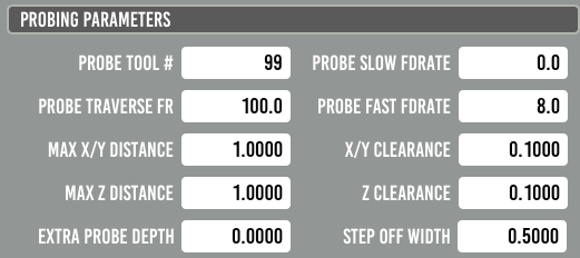

Not at the mill now, but here are the parameter values I was fiddling with last night:
Traverse: 50-60ipm
Slow probe: 1-4ipm
Fast probe: 15-25ipm
XY back-off clearance: 0.025"-0.050"
Z back-off: 0.025"-0.050"
I can certainly test other values tonight - perhaps start with slow=0, and fast=10ipm?
Traverse: 50-60ipm
Slow probe: 1-4ipm

yeah bump up that clearance, you are likely blowing through that small clearance amount on the fast feed rate if using a wireless probe, give it 0.100 - 0.1500" if using fast and slow probe, make sure you calibration is done at the same final feedrate. to start i would use just a single touch with slowfr zeroed out. try the below parameters and report back:Not at the mill now, but here are the parameter values I was fiddling with last night:
Traverse: 50-60ipm
Slow probe: 1-4ipm

Well that did the trick.
Removed the second slow probe, increased the fast probe speed to 8, and cut debounce back down to 2.
10 out of 10 clean probes!
Upped the speed to 25, re-calibrated, and it's still repeating perfectly. Deviation between pocket probes is maybe 0.0001" 2 out of 10 sequential probes. The other 8 of 10 are perfect repeats.
Even found a probe rotational position where X and Y are a perfect match.
Thanks a TON for the assistance. Now I just need to figure out how to incorporate the probe's error signal in to the probing routines so it stops if the RF error is present during the probing.

Great news! Glad you got it sorted! 25 is a bit fast for small holes, I would recommend finding a balance to be able to achieve full acceleration in small holes to ensure the probe event is at speed for best consistency. But finding the sweet spot is easy now that you're not getting errors.
