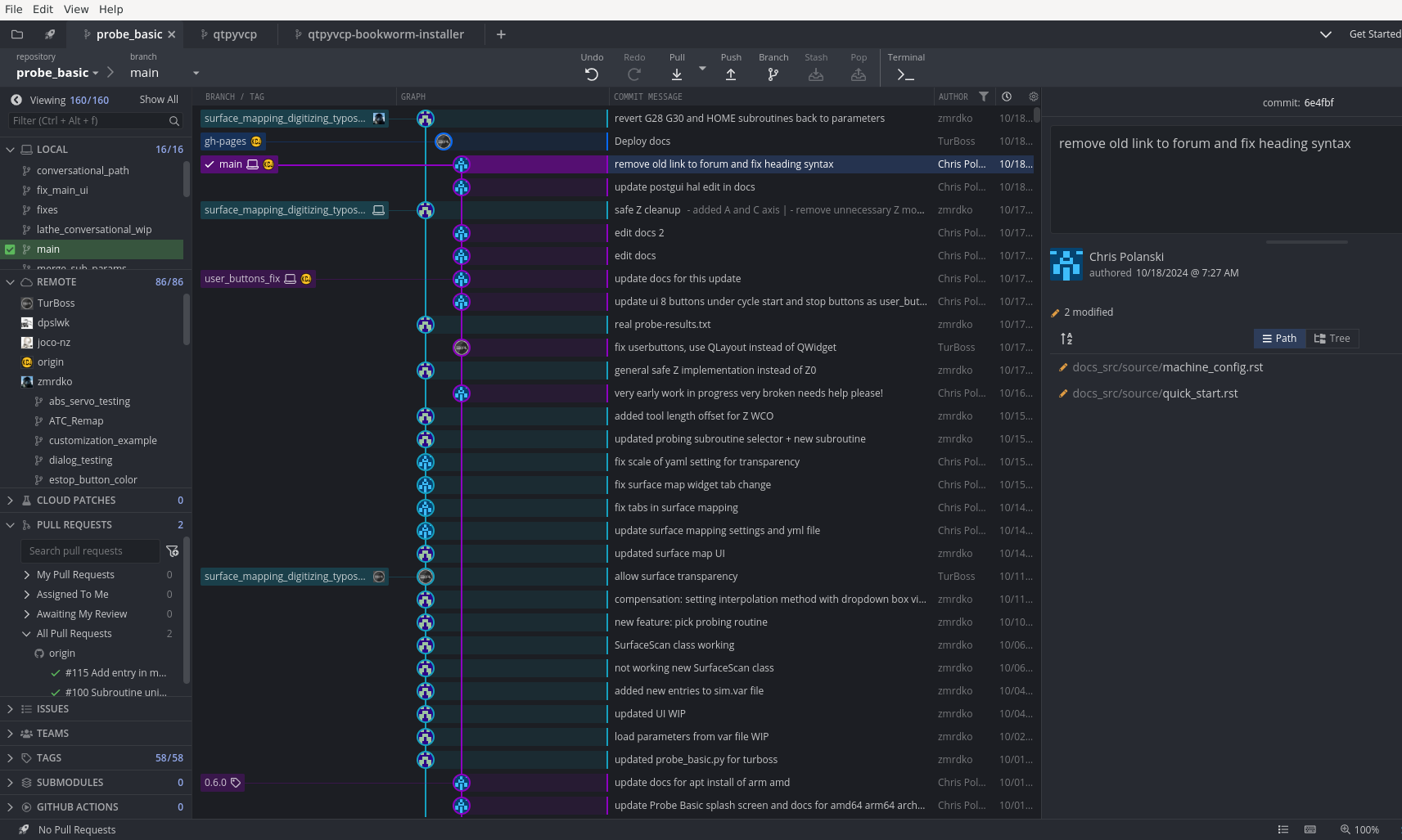

i use gitkraken, it msakes things very easy and visual which works best for me, i get confused using git from terminal, too much to remember when making so many changes so i have forgotten how to do it manually. but if youre wanting to dev, i would say install gitkraken and just add the folders in the dev for probe basic and qtpyvcp then you can preview all the latest and locked sown branches and have your own running branch.
