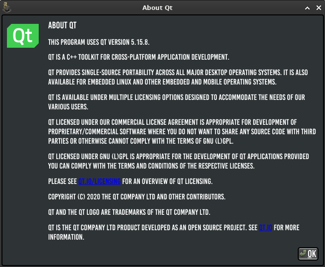

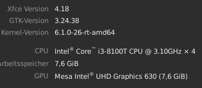

- Jensner
- Posts: 151
- Thank you received: 28
21 Oct 2024 03:50 - 21 Oct 2024 03:56 #312724
by Jensner
Replied by Jensner on topic Version aktualisieren + diverse Fehlermeldungen
I try it:
- Debian Version 6.1.0-26-rt-amd64
Rest as a screenshot.
Is there an easy command finding out all the versions? (for debian, i found "uname -r")
The rest as screenshots.
Hope this is the right info..
Debian (Xfce):
LinuxCNC
Probe Basic
sudo apt update sayes everything is up todate
Thanks a lot
Jens
