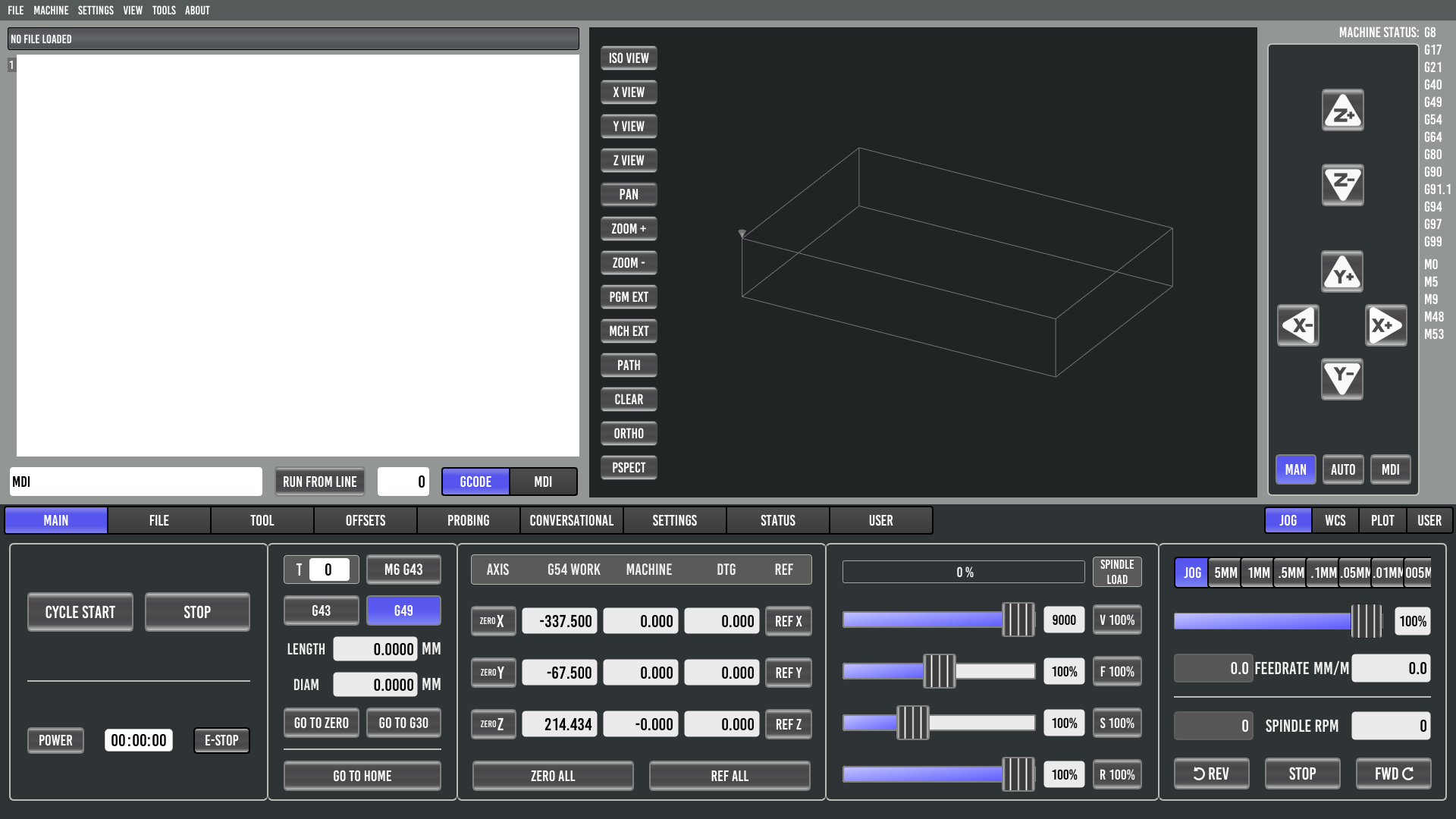

I just re-installed my Debian as I messed something up with my system config. I saved my Linuxcnc config so I just needed to reinstall and put back my config. So far, everything worked except for the Probe Basic GUI that is missing a few buttons.
In the lower left, I noticed a few buttons missing (run from line, Flood mist etc). I first used the APT Stable install and then switched to the develop branch but I have the same issue.
Does anyone know how to fix this?

can you verify, if it shows the same in the sim config?

Oh, wow. The Sim has all the Buttons! So it seems to be my configuration? All I backed up was my Machine config. Maybe I have to change it file for file...

Ini setting for user buttons and new user button folder are needed, copy from sim config

That was the issue! Thanks
However, I now have the button "reload PGM" and "clear PGM" instead of "run from line". Is there a way to add it back in?

run from line was moved above to the mdi line, if you are upgrading from an older version you need to make sure the new sunroutine folder is used and also add the new probe basic variables to the .var file in your config. the updates are up in the new docs here:
kcjengr.github.io/probe_basic/machine_config.html
parameters required in the var are shown here:
kcjengr.github.io/probe_basic/probe_basic_parameters.html
