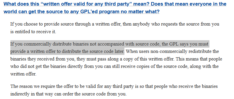

25 Oct 2024 12:58 #313207
by spumco
I believe LCNC is covered under GNU GPL-2.0 (as published on github).
The GNU page has a quite good FAQ on the license, but as with most legal issues nothing is black and white.
It's possible that because APSX (and other LCNC re-packagers) are distributing LCNC-derived software to the public, they are required to provide source code to anyone who asks - but I'm not an IP lawyer.
There are plenty of smart people around who are intimately familiar with the details of enforcing/managing a GPL license.
Replied by spumco on topic Russian machine tool company that uses LinuxCNC with Probe Basic
Yeah that is shameful, and pretty sure it is illegal. Did anyone check our license?
