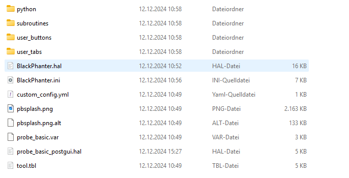

i have some problems to convert my *ini and *hal file from QT-Dragon to Probe basic. Have some errors when i start it. I screenshot my CNC Folder.
i cant find the error. please help me that i can start it

Hi, changed my Config. I get an error with the path from this. But i attached a screenshoot with my folder.
FileNotFoundError: [Errno 2] Datei oder Verzeichnis nicht gefunden: 'user_tabs/
USER_TABS_PATH = user_tabs/ # REQUIRED Setting for Probe Basic
USER_BUTTONS_PATH = user_buttons/ # REQUIRED Setting for Probe Basic

- Lcvette
- Posts: 1682
- Thank you received: 784
16 Dec 2024 16:34 #316769
by Lcvette
Replied by Lcvette on topic Probe Basic do not start
Copy those folders from the sim per the docs
- Blume
- Posts: 42
16 Dec 2024 19:19 - 16 Dec 2024 19:20 #316794
by Blume
Replied by Blume on topic Probe Basic do not start
Hi, my fault was that i copy the foldes from the folder /machine_setup_files
know i take the folders from the sim folder.
