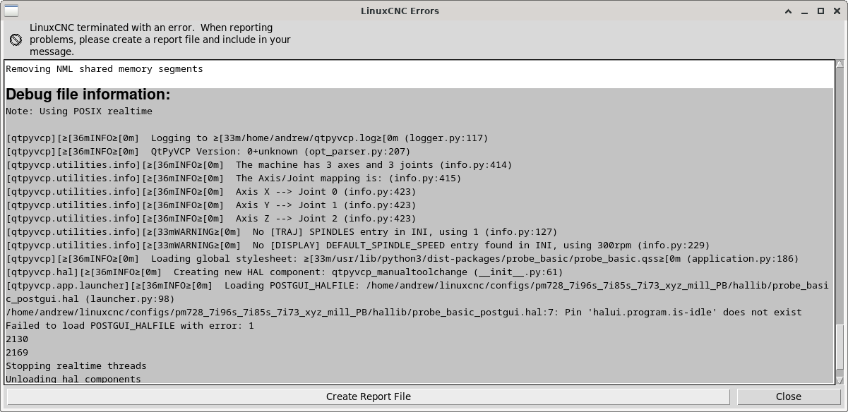

Ok. I have a feeling that this is going to be either easy, OR a long road. I have the system popping up with no errors, however, when I try and test homing I get the following:Named parameter #<geometry> not defined. I cant seem to get it to complete anything else other than jogging and coolant pump Mist and Flood activations.

Add geometry ini line, that determines which dro displays are shown
Yes post gui hal must include what's in the docs. Add your current items below the probe basic items.

Your missing some things from config docs still,
AXES = ?
GEOMETRY = ?
AXES = ?
GEOMETRY = ?
