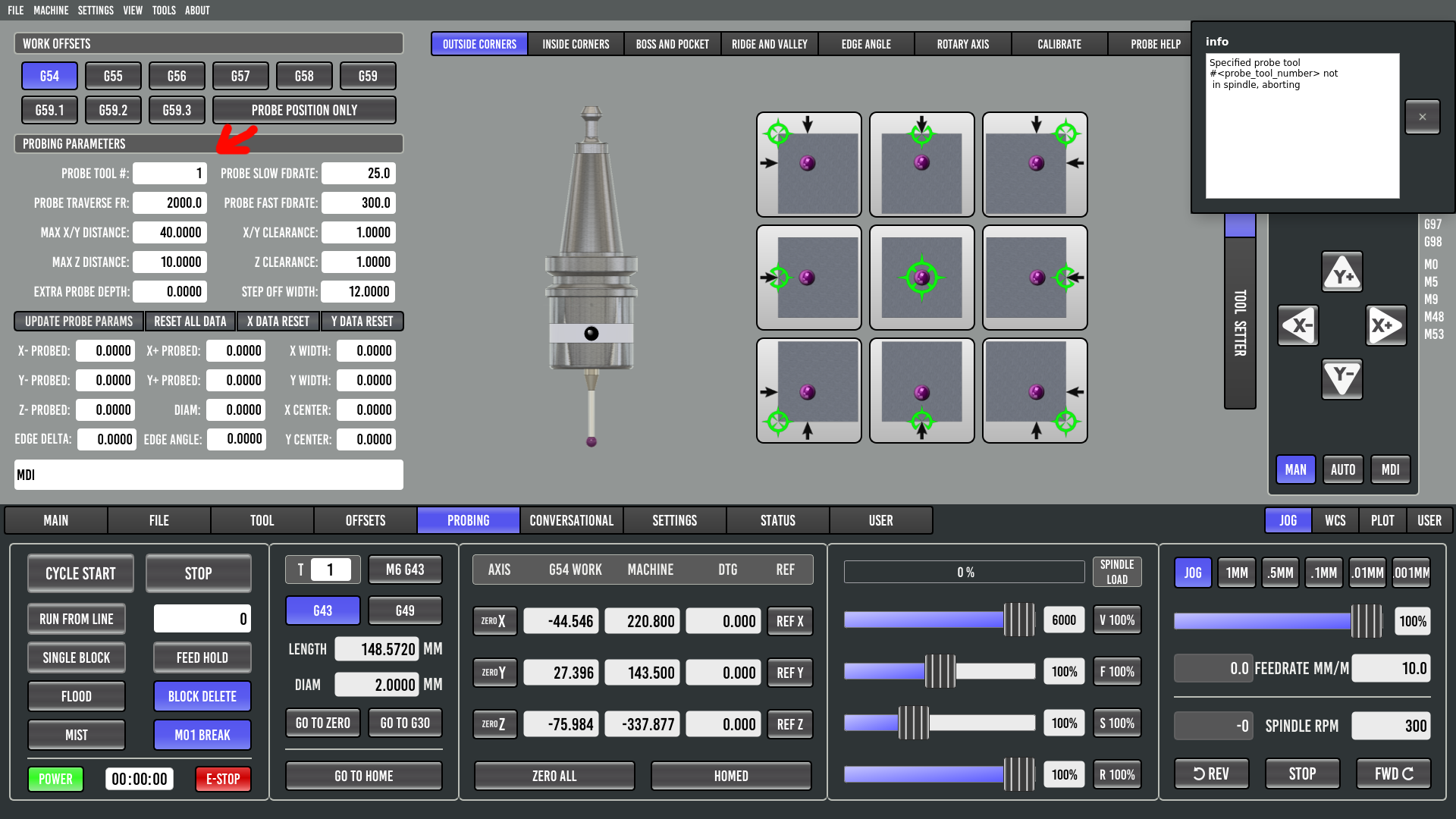

I recently did an upgrade of Probe Basic and LinuxCNC, here are the versions I upgraded from and to.
linuxcnc-uspace/linuxcnc 1:2.9.3 amd64 [upgradable from: 1:2.9.2]
python3-qtpyvcp/stable 4.1.2 all [upgradable from: 4.0-124.dev]
python3-probe-basic/stable 0.6.0 all [upgradable from: 0.5.3-219.dev]

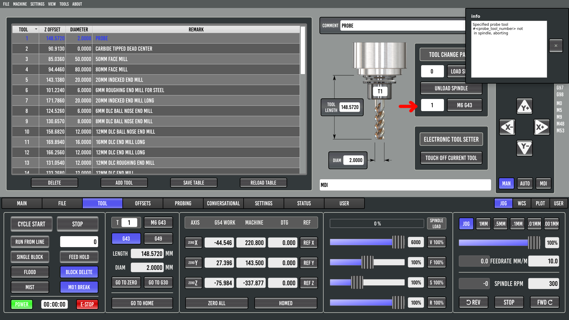

After doing this upgrade and updating the corresponding Probe Basic configuration files I've come across an odd error relating to probing.
When I try to do any probing I get the following error message even though I already have to correct tool loaded.
If I re-enter the value "1" in the "Probe tool" field under "Probing parameters" everything works again until I restart Probe Basic.

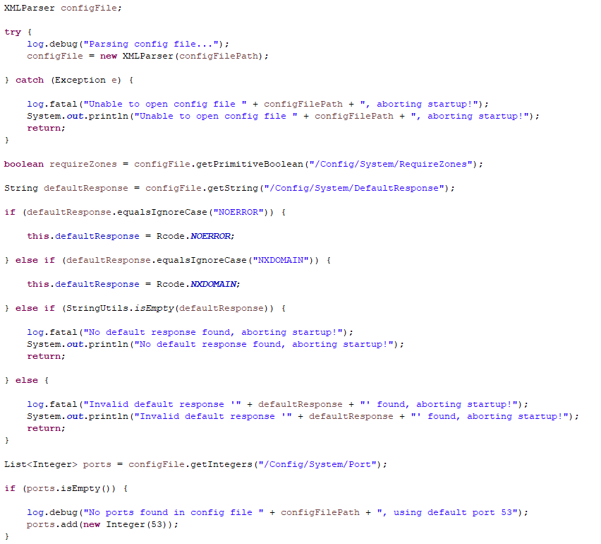

07 Jan 2025 20:26 #318344 by Unlogic
For most of the Java applications I've written over the years I included sanity checks of the configuration that executed as early as possible during the startup process before something else had the possibility of crashing due to missing invalid or configuration.
Below is a snippet of code from the Java based DNS server I wrote long ago (unlogic.se/projects/eagledns).
Now given how good LinuxCNC and Probe Basic is working I haven't really had to roll up my sleeves and get to familiar with how the bootstrap/initialization of the user interfaces works. But I guess in the case of Probe Basic maybe a hook or method for checking the configuration could be added in QtPyVCP that each derived user interface could then implement and check the configurations before QtPyVCP  proceeds to load the actual GUI.
