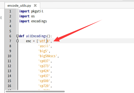

The program cannot work correctly with Cyrillic characters in the text program.
I am attaching a file with Russian characters. I'm asking for help. How can I make probebasic understand Cyrillic?

Good afternoon.
Thank you! Everything worked out for me.
I had to try different encoding options.

I just tried it and solved the issue for myself for the future.
I have difficulty updating to the new version of qtvcp and probebasic. I decided to postpone this process. I don't have time yet. But in the test configuration I tried the encoding cp1251, if I remember correctly. The test configuration reads my files correctly, but my machine does not work. I hope I am expressing my thoughts clearly.
In the first position of the encode_utils.py file I inserted the cp1251 encoding
But you can check it yourself. At the beginning of the topic I attached a file with Russian text.

ok great, will have a look. need to see if there is a way to have that set from system preferences maybe. hmmm
